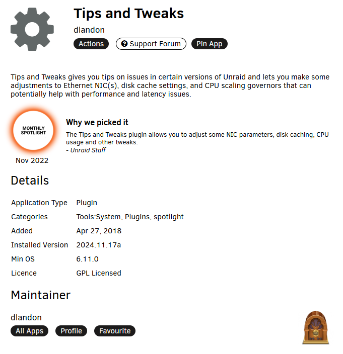

install tips and tweaks plugin
Plugin click on the gears "Settings/TipsAndTweaks"
at the bottom add samba:
you are correct it is best to sop all vm and docker before stoping the array...
I already have that running. For a few weeks now and still have issues I'm afraid.
did you add smaba to the bottom so it says ssh,bash,samba ???
Oops missed that. Looking on my phone all a bit small. Will add that now.
Is that all I should do?
I think so do you use nfs? if so i need to grab what is called to stop that too.

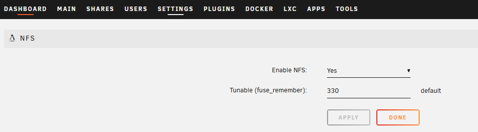

Unless you're using Linux and NFS, you would have to enable that in Settings and Shares.
I think that should be fine for testing.
I still recommend stopping Dockers/VMs before any planned reboots. Unraid will have a stop script that runs after 15 minutes.
Adding "Samba" to the "Tips and Tweaks" to terminate any open SMB connections will help fix any lingering open file-sharing connections when the system goes down for disk or reboots.
to check if nfs is running go to setting > nfs
to see if any shares are enabled:
click shares :
alternative, you can run linux command
cat /etc/exports
