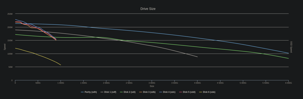

This is what it looks like with nothing else accessing the disks.
That looks normal, depending on the location you are writing to, writes can slow down to 50MB/s, if they overlap with the slower section from disk6, still shouldn0t be nowhere near 10MB/s, maybe something else was reading from the array at the time?
Yeah I noticed disk6.  Its an old laptop hard drive and figured it would slow everything down.  So I pulled it.  Rebuilding parity now and its writing at 173MB/s.  So I think that drive might have just been screwing everything up finally and even when not being written to, causing problems.
