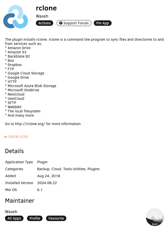

rclone is the web ui version of this as well has decent comuntiy support
which is rsync via a web ui.
