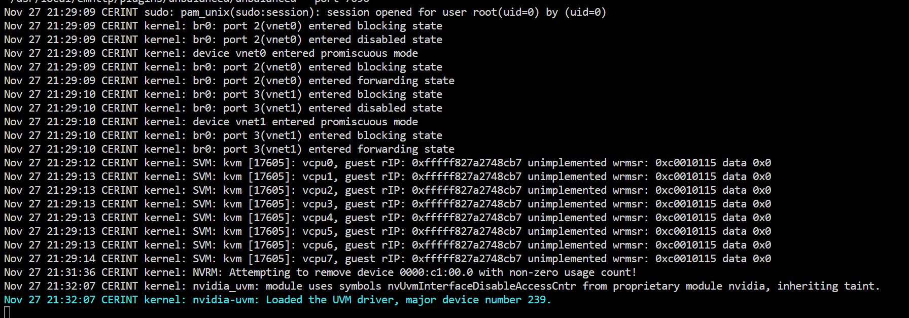

November 27, 20241 yr Hello, I am having an issue with trying to passthrough a gpu to a VM. I have an UnRaid server with: 1) ASRockRack ROMED8-2T/BCM 2) AMD EPYC 7282 16-Core 3) Nvidia tesla P4 & Tesla P100 I am already running a couple of VMs with no gpus. I installed a fresh ubuntu server 22.04 VM with no issues. Then i tried to passthrough the P100 gpu. the moment i start the VM the unraid GUI freezes. Any tab i try to go to it just keeps loading and never loads the page. My only option is to do hard reboot. The interesting bit is that the services / websites running on the other VMs run fine. Even with the unraid gui unresponsive / not loading. I wonder if i need to do anything extra than just selecting the GPU in the dropdown? If I select the GPU the server gui freezes and i can not reconnect to this vm. So any config needs to happen on the xml? Thanks, George Edited November 27, 20241 yr by [email protected] More info

November 27, 20241 yr Author Epyc CPUs do not have a integrated iGPU unfortunately. No, the P100 is not used by docker. Also there is not display connected to the GPU as it has no display ports and no sound. Its a Nvidia Tesla. I don't need it for display. I plan use it for compute. I checked the box in the tools and rebooted the server. Assigned the GPU to the VM Started the VM For a minute or so the server was still responsive but eventually the GUI froze again. However i opened the logs before starting the VM.
