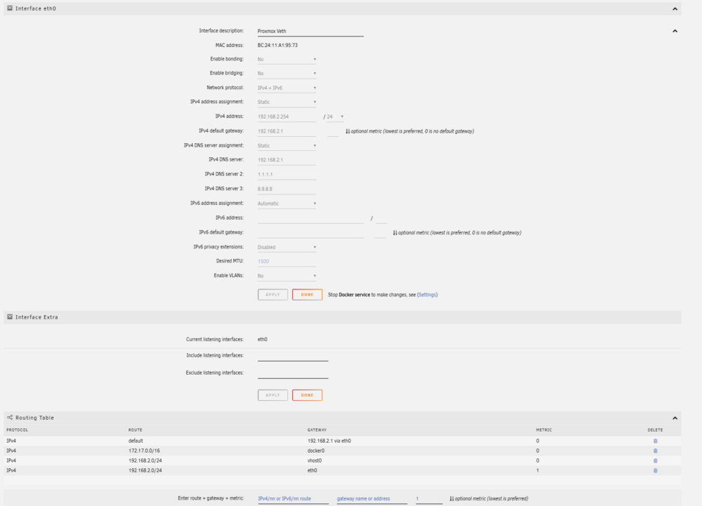

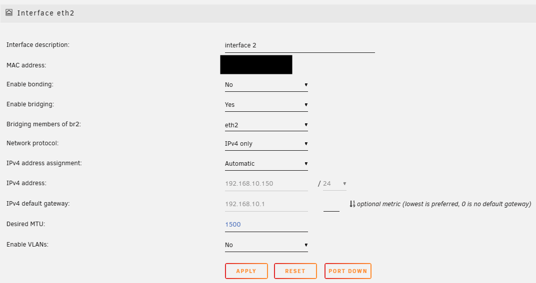

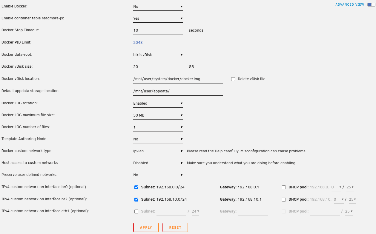

I do not see any field called "Docker Custom Network Settings" under Settings > Docker to add the DNS.  The below are the only fields I see.
Below are the settings for `eth2` of which there is no DNS fields like there is for `eth0`.
If I am creating a new network, how am I ensuring it only uses eth2 which is physically connected to the subnet?

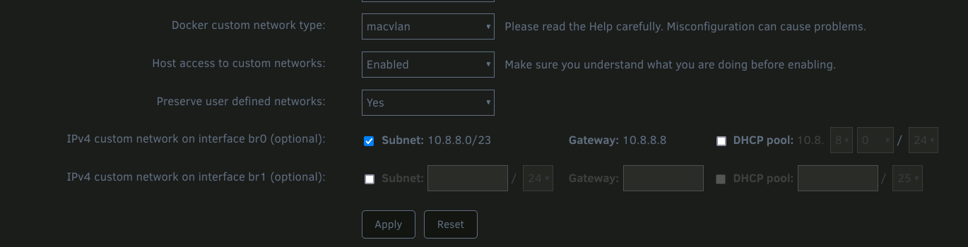

-o parent=eth2: Sets the physical interface to eth2 for the macvlan network.
mcavlan: The name of the Docker network you're creating.
setting your switch 2 subnet information...
then move to step 6...
as you have a network misconfiguration on unraid. Potential network configuration need on your subnets.
Sorry to be a pain.  But I followed your steps above and I am still not able to get DNS working in that network. I even deleted the existing network and recreated it with your command above. I am at a loss of what to do at this point.  I can believe it is this complicated to get a docker network to work on a second nic.
Did you by any chance see the custom network at the bottom of your Docker settings and configure the subnet and gateway there?
I played around a bit just to see if I was able to create and assign the network - which I was. But I'd have to make additional changes to allow connecting to a different subnet from the first to then properly test the docker's DNS - which I haven't done.
I do see both networks and they seem to be configured correctly.  To reiterate, the container gets an IP address on that second subnet and I am able to access it.  Though that container does not have DNS properly configured to use my local resolver to access other devices on that subnet by hostname.
