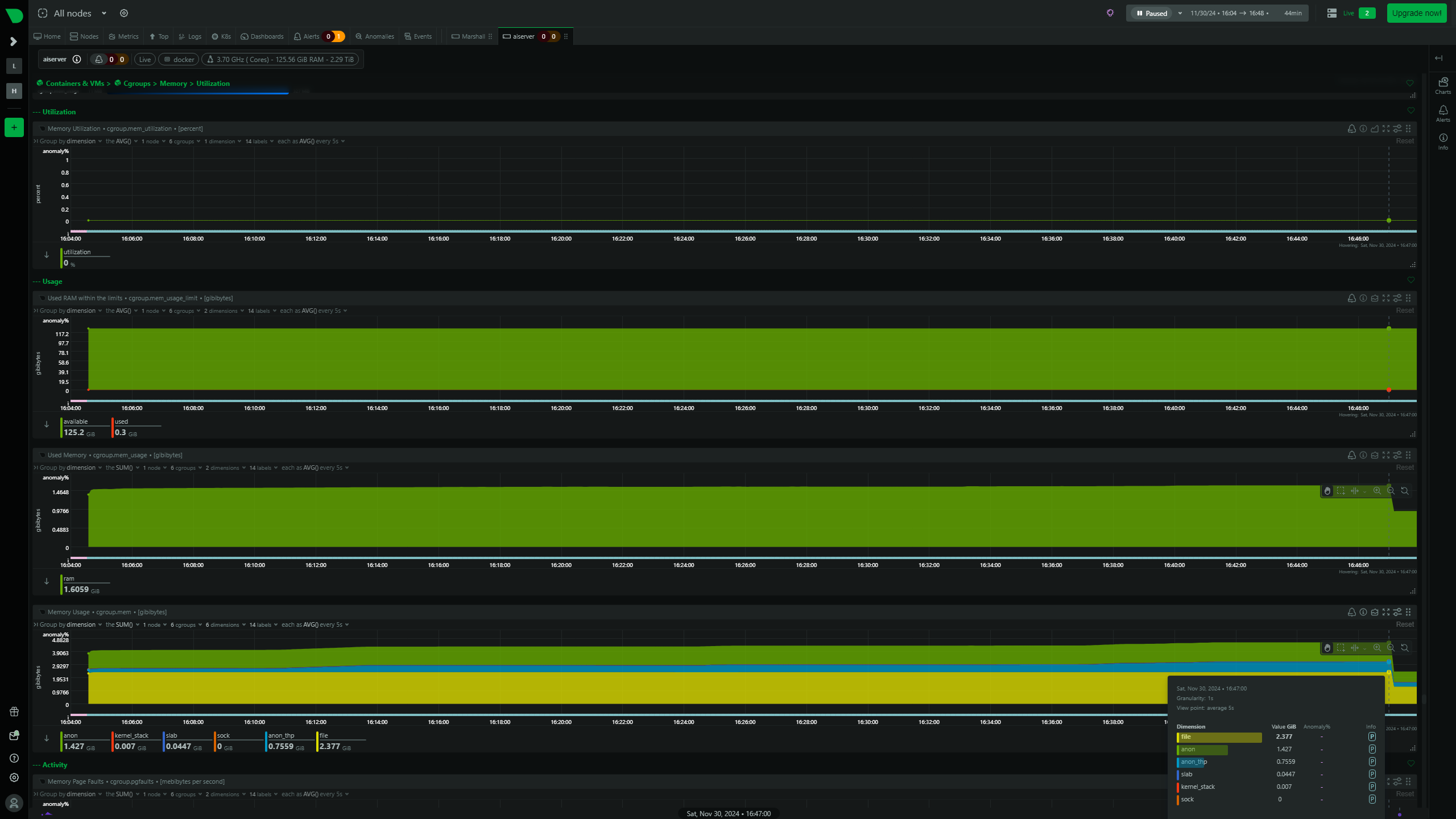

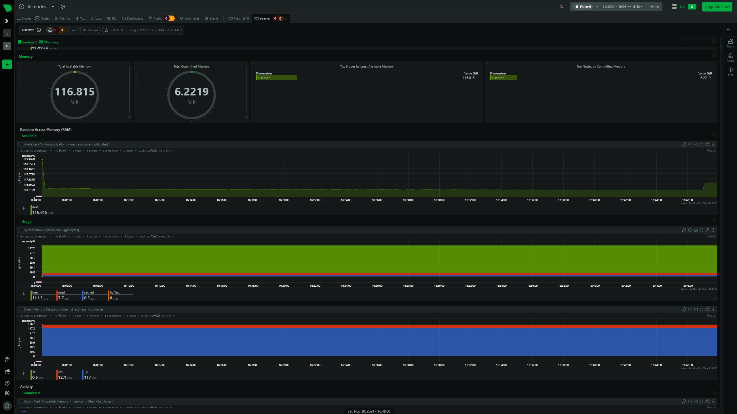

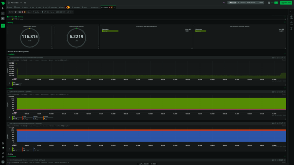

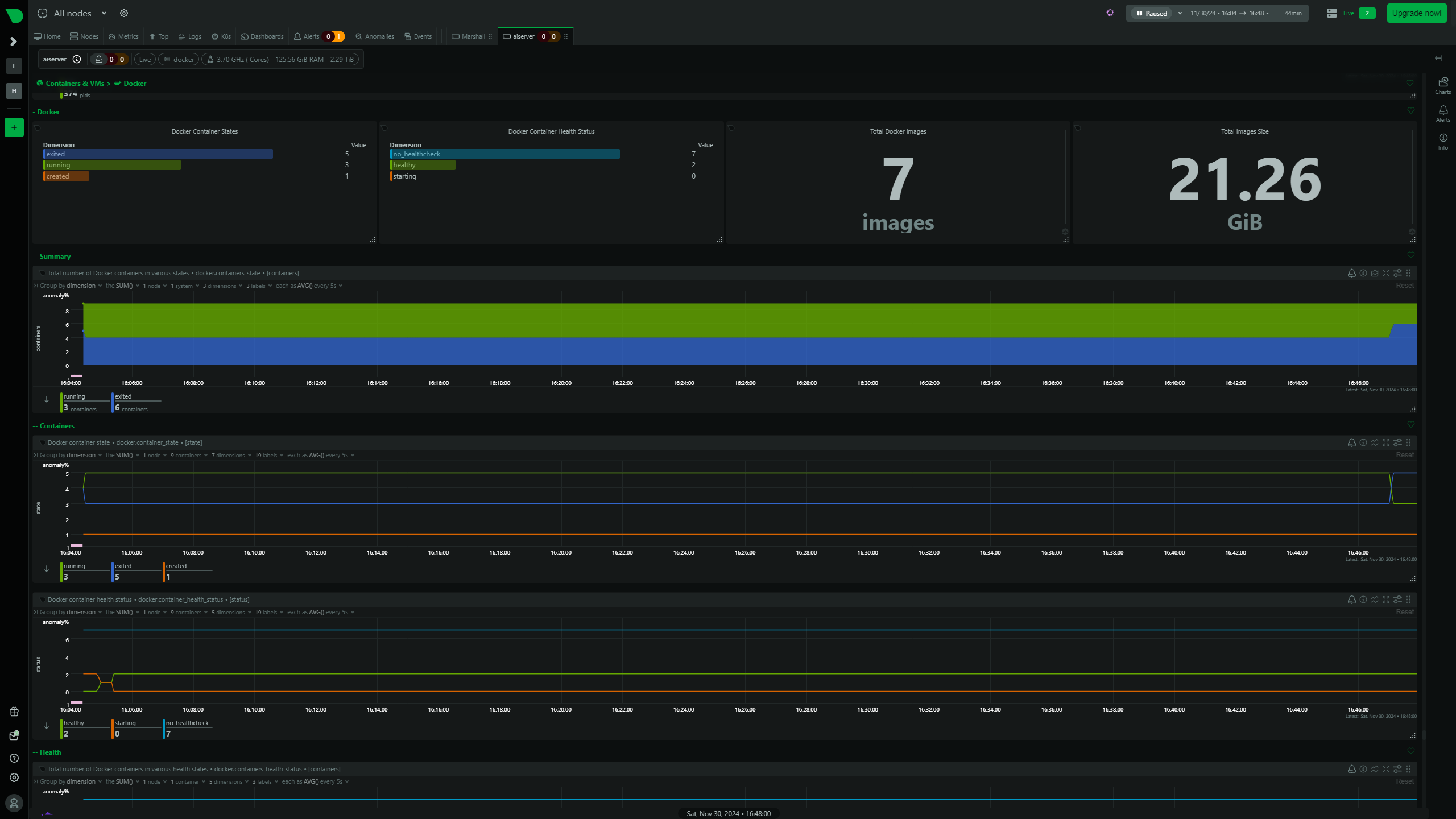

Thank you for the feedback, @bmartino1.
I've attached screenshots from NetData for the range of the first Syslog I attached, when all services sat idle until failure.  There doesn't appear to be a memory leak, and the moment the containers stopped is shown at ~16:47:02.  No sign of a radical change at that time.
You can see that the system has 128GB of rDimms and everything is consistent.
I'll go back to testing a bit with `--runtime=nvidia` & `--gpus=all` in the extra parameters.  It is intriguing that Tdarr runs happily with `--gpus=all` this whole time.  Additionally, if it were a runaway GPU memory I'd expect, from prior experience, the GPU lock up or all containers using the GPU to fail; whereas Tdarr hums along happily.
This issue has persisted for these two containers whereas Tdarr runs without issue.  I put this is General as it is a Beta system, but it's very curious.  Tested combinations of `--runtime=nvidia` & `--gpus=all` in the extra parameters.  Even with only one test container running and system restarted so that only the test container and NetData run at array start.
Review and suggestions are welcome.  If there's particular piece of data you'd like to see for a given container start/failure, please ask.
