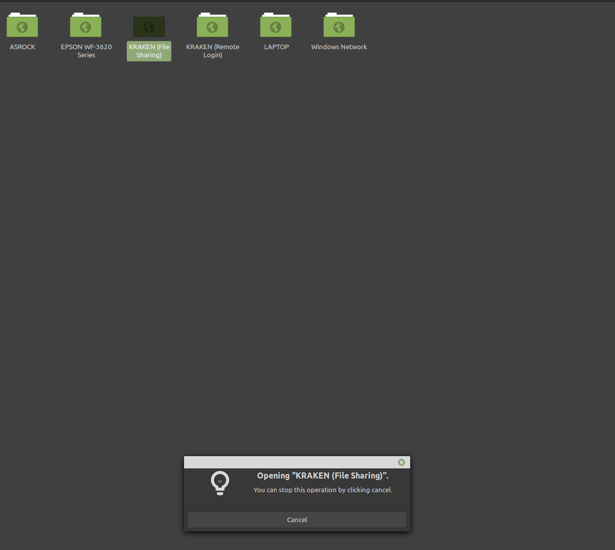

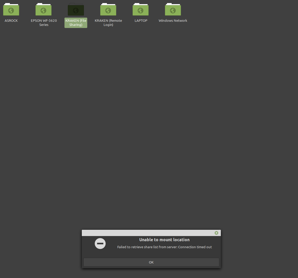

Hello, sorry to be baack but I have another problem.

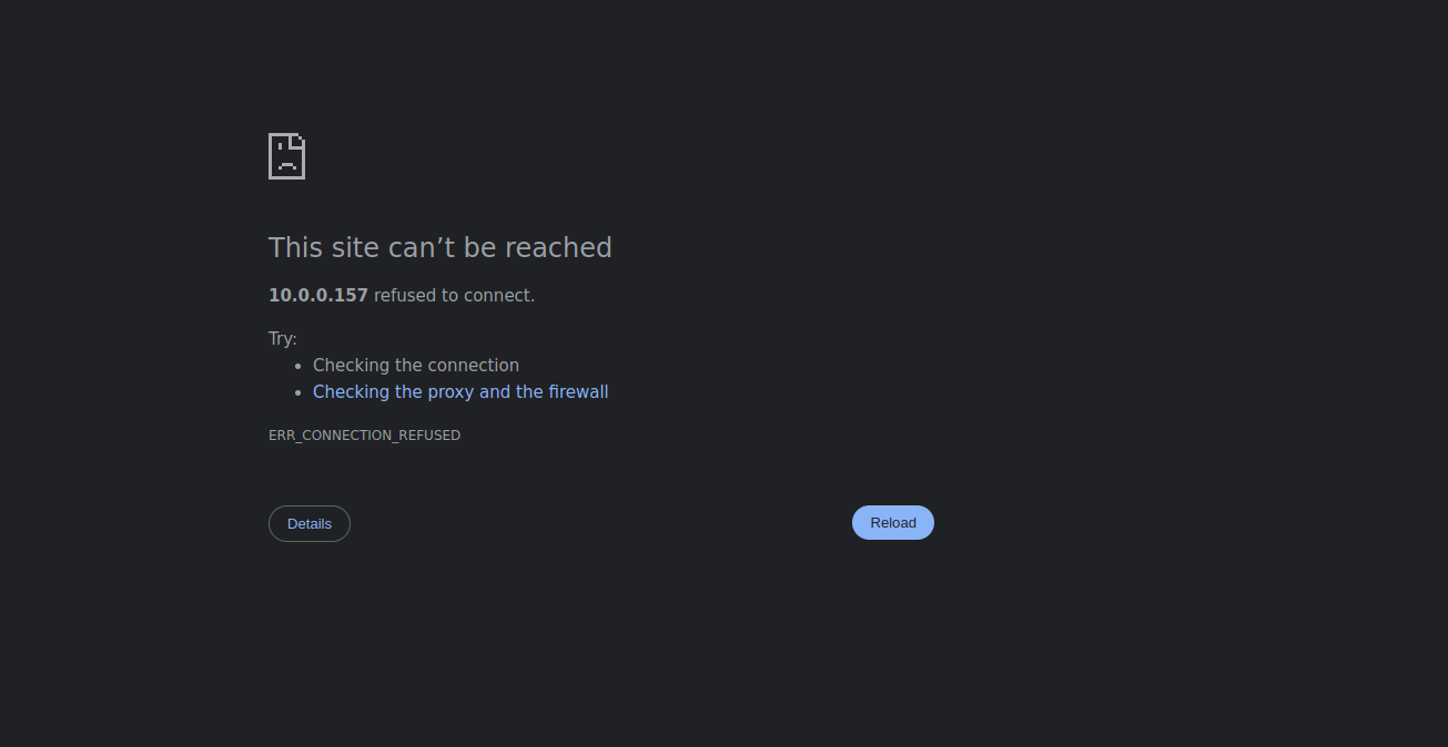

My linux mint machine had what I can say is BSOD. they system crashed why running a bunch of stuff.
When it reboot back I was no longer able to connect to my unraid with the file explorer or the website.
all browser tab that were open not longer have a connection, plex, krusader, torrent. unraid is still up and running, my linux machine just cant connect to it. the plex client on the linux machine does still work.  everything on my linux machine still works i got internet, I can connect to my router. i just cant connect to unraid.  I did make a bunch of changes to the network setting on unraid, added some new hardware, i'm still completing the upgrade but it was  finish. I just needed to close the case and put the GPU back in.  the upgrade was a new NVME 2TB cache drive.  I connected my phone to unraid and it sees everything.
times out when i try the webpage and when usging file manger it times out also.  So any help you be great

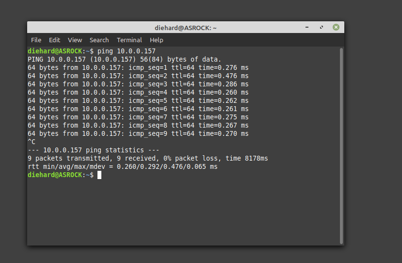

in termainl can you ping it?
ping 10.0.0.157

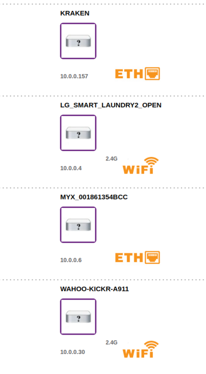

whats it mac?
arp -a 10.0.0.157

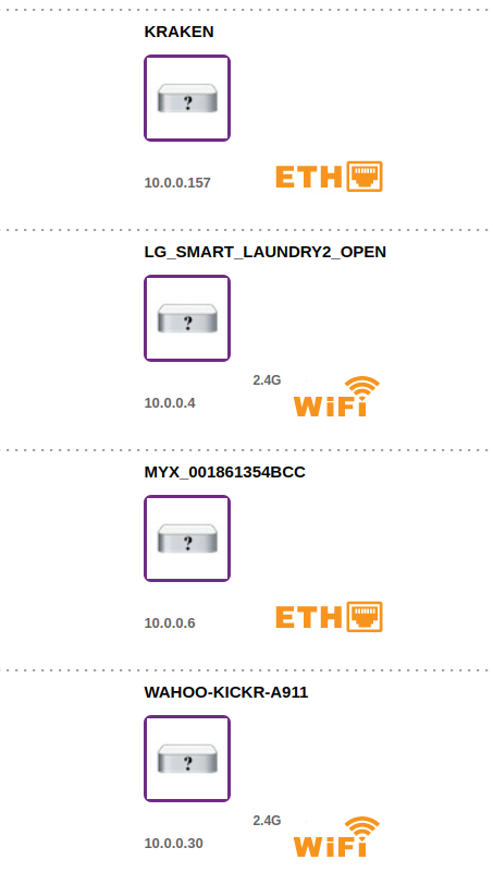

what does your router say unraid IP, is unraid set to a staic IP address if on DHCP the ip may have changed...

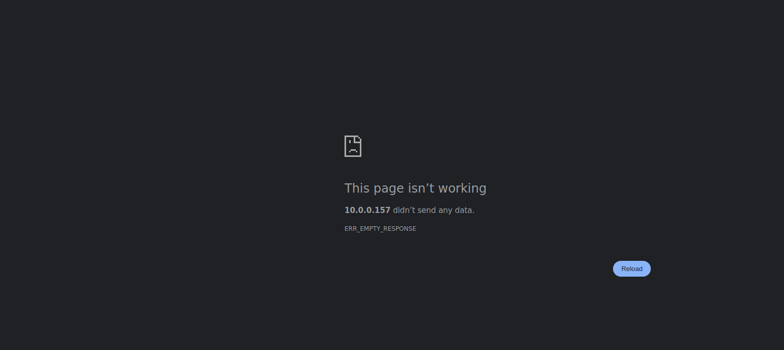

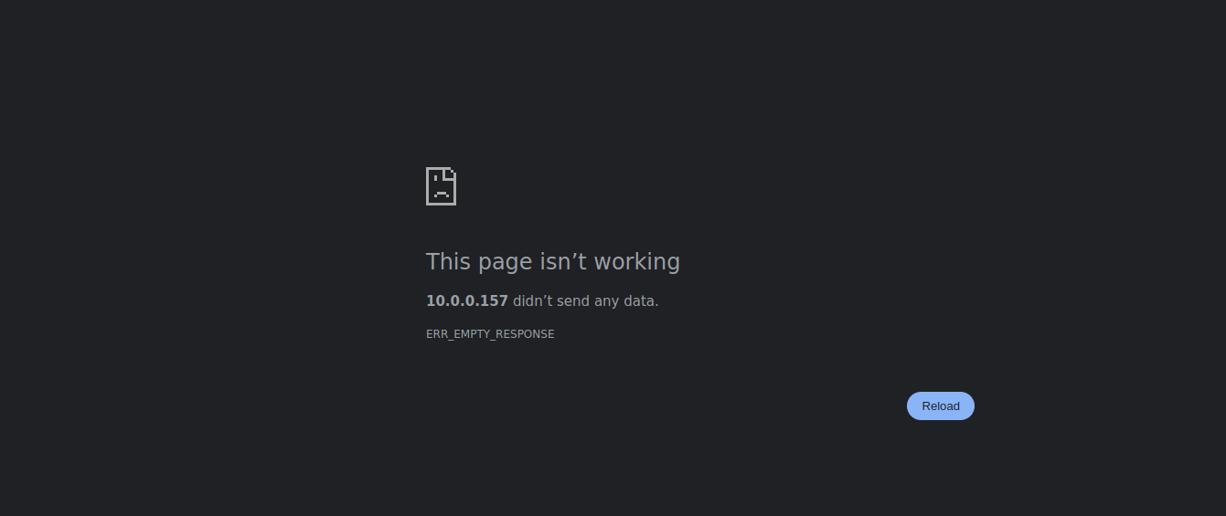

I have not cycled unraid, it seems like it's only the one this computer. after the crash it wont connect to unraid. I rand both address and no luck. router says the ip is what i posted and no it's not static IP. As for the diag I will post from the other computer it seem to connect no problem.

rebooted both the linux computer and unraid and still can get to the login
can you access the web ui on a differnt machine like your phone?
if not this sounds like a docker web server taking over unraids webserver ports as teh docer is runnign in host mode...
Otherwise did you edit the go file in unraid? is emhttp running?
regarldess you need termainl access of some kind to the unraid machine. time to connect a keybaord and monitor to unraid...

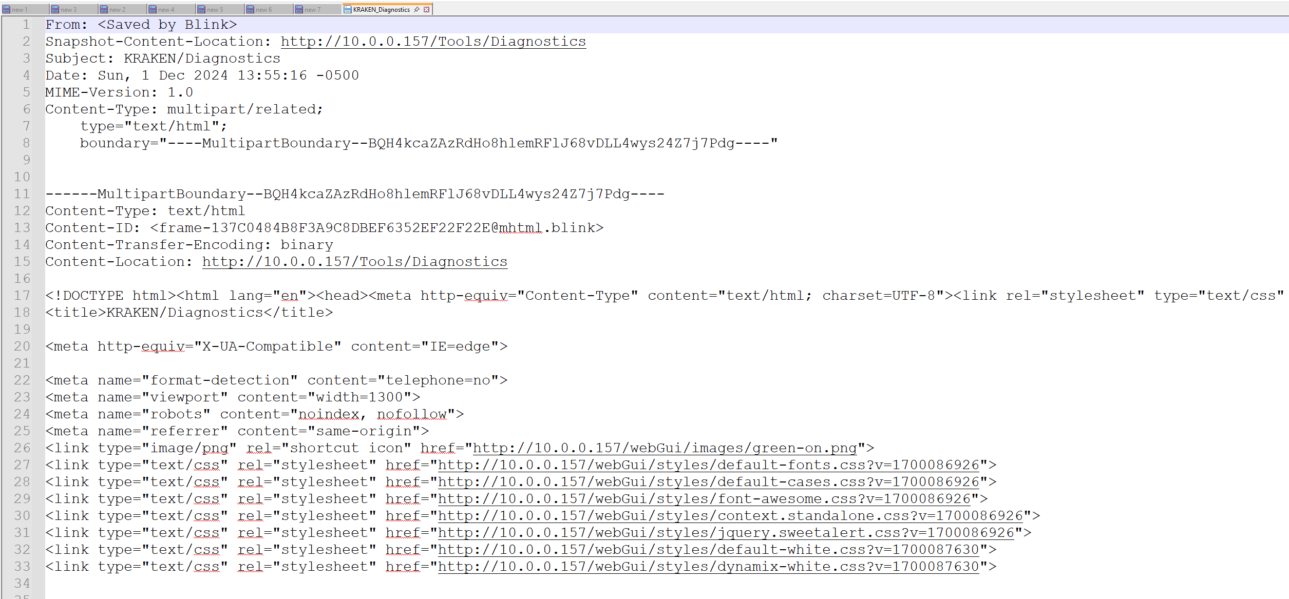

diag are a bunch of linux logs text files in a folder in a zip
I just open it with a txt editor and there was data in it but i will try again
KRAKEN_Diagnostics
Edited by diehard2k9
that is not unraid diag file i don't know what your doing to get that
your saving a hyper link onthe phone most likely and not geig the zip file...
try again..

ok let me know if this is it?
kraken-diagnostics-20241201-1412.zip

Like I said the only connection I can make from the linux mint is using the plex client I am able to play all the media there, when pinging that IP , I am able to ping it. file browser and web connect doesnt work. I dont know what it could be cuase it was running fine before linux mint crashed and reboot. that when the problem started. linux  runs fine connects to everything I was using before but unraid. So i dont know what to do to fix it.
