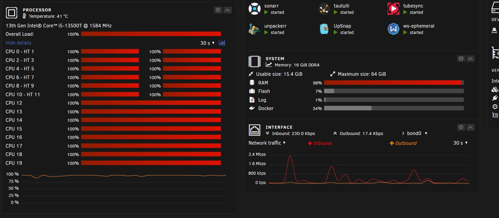

I upgraded to 6.12.14, changed to ipvlan and started Handbrake again. This time I happened to be looking at the dashboard when it crashed: RAM & CPU usage suddenly jumped up to 100% (from about 48% on RAM and 80% on CPU) as shown in the photo. Attached are the logs of this crash, hopefully there is something of value in them this time.
syslog-previous(1)
Sounds like a container issue, it may be running the server out of RAM
Ok, thanks. Would setting a memory limit of something like 4GB for handbrakes container fix it?
EDIT: Well maybe not fix it but make so it can’t crash my server
