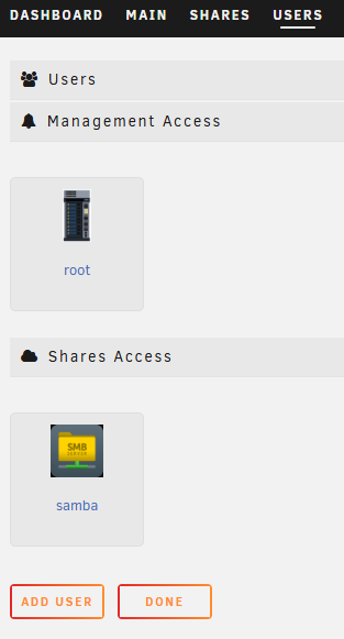

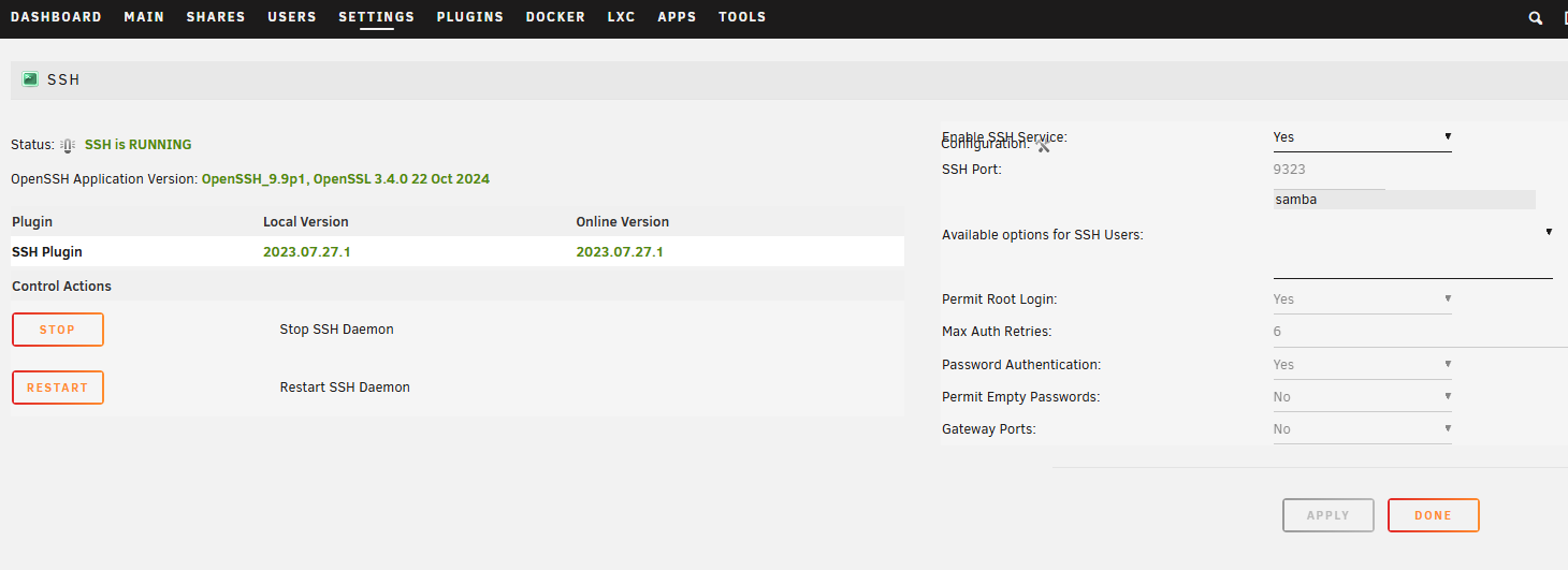

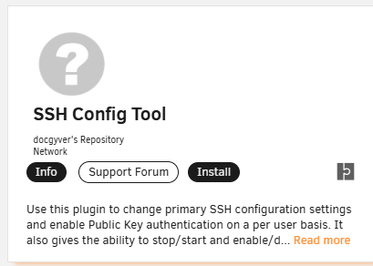

I use the plugin ssh config tool for use with unriad ssh server.
then i can run the passwd comand in unriad termainl to make a user.
as Unrad by default won't let you create a managment user outside of root due to acess and other ACL issues.
with the ssh config tool:
you can add other ssh users and levlage this to have a su in unraid.
Due to security and the ssh conf I don't recommend running that tool but then in terminal I would run passwd samba and have a password to the account and then su samba to login to samba stuff. At this level you may ned to have added other setting to grant samba access to stuff. so a usermod -aG root samba in my case to grant samba root access.
Then it becomes turtles all the way down. This is really insecure, though!
