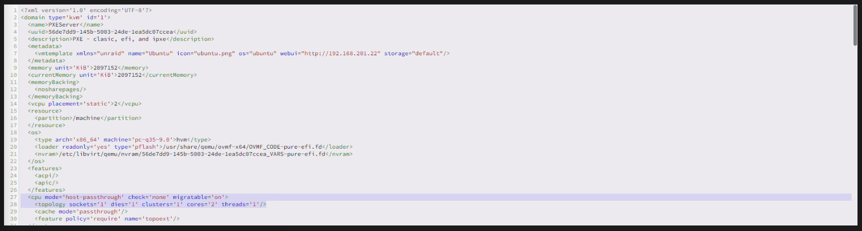

Here is a linux example of the custom xml code to edit. Note CPU tune is deleted. VCPU is set so x virtual cpu to the server and cpu host mode with correct topology for # of threads is set.
