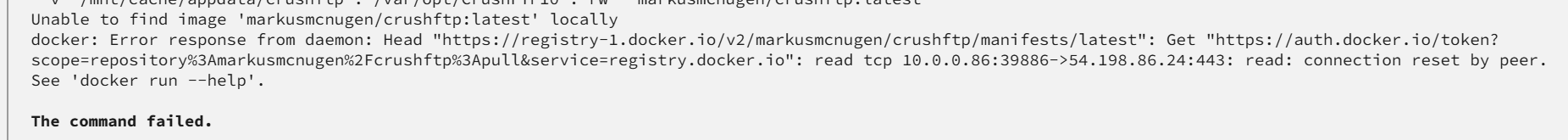

https://registry-1.docker.io/ unreachable images not pulling or updating
Most docker containers will not update and new apps can't be installed.
It appears that https://registry-1.docker.io/ errors out.
A global ping test shows it as unreachable.
Solved by David McLuckie
Try setting static DNS addresses of 208.67.222.222 and 208.67.220.220
Barring that, post your diagnostics
My ISP, YouFibre (or at least the endpoint I connect to), is blocking access and preventing app installation and updates.
I found a method to route all UnRaid traffic through a VPN to bypass.
