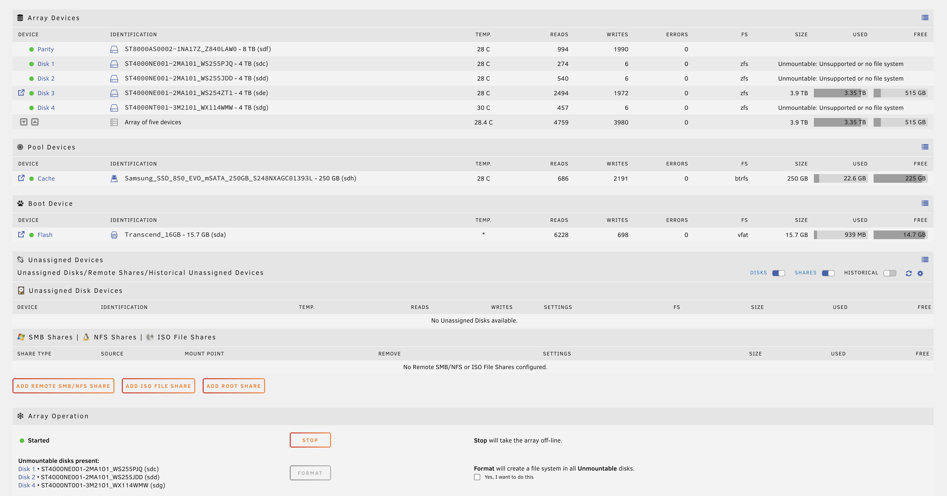

I have a serious problem with my Unraid server consisting of 5 disks, 4 data and 1 parity. I changed the server and moved the disks, but most likely the data or power cables were faulty...
After a correct startup, the server started failing after I turned it off and on several times in a short period. At first, one disk wouldn't mount, then another, and now only one data disk remains mountable...
I'm sure the disks aren't defective because they always worked well in the old server. However, the new server with a different motherboard and cables caused the issue...
I put the disks back into the old server and restarted Unraid, but the current situation is as shown in the attached image.
Is there a way to repair the partitions or mount them to recover the data???
Please help me, all my personal data, photos, files, etc., from the past 20 years are on those disks. I'm desperate.

I’m attaching photos and diagnostics.Screenshot2024-12-18alle20_27_52.thumb.png.fc0aa7133a4d2943b9c6d8a671ae1ba1.png
