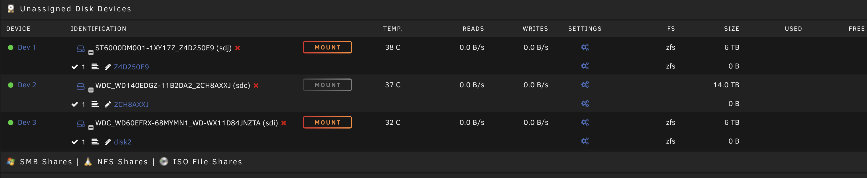

Something seems to be different with these disks:

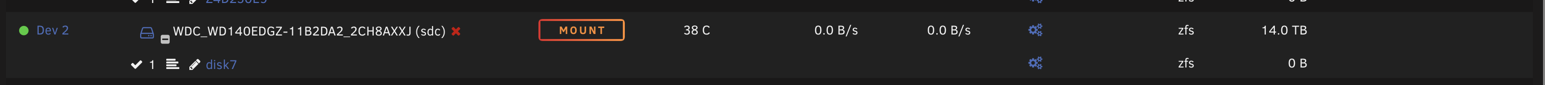

1 is not mountable in Udev, even though it was mounted in the array. The other 2 are mountable. It seems to have something to do with the pool names.
Here is the zpool import for sdc which was mounted in the array as disk7:
   pool: disk7
  state: ONLINE
action: The pool can be imported using its name or numeric identifier.
config:
disk7       ONLINE
  sdc1      ONLINE
How would I make it mountable in Udev?
How would I make future drives mountable in both Udev and Arrays?
Thanks
I ran zpool import disk7 and now it shows up in Udev as disk7:
but I feel like there will be a conflict when or if I add a disk7 to the array esp a zfs disk since the pool names will collide.
I think this is how I ran into a problem with missing a mount that I posted about in another thread.
