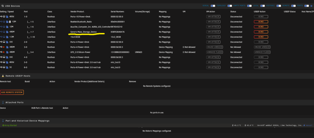

Very new to this so forgive me for my ignorance.
I'm trying to figure out how to get the keyboard and mouse to work with unraid through my TESmart HKS0402A2U KVM. At this point I have no VMs and the reason I need to do this is I'll eventually be upgrading my network and will be installing a NIC so if in the event that I cannot connect for whatever reason I'd like to be able to manage Unraid via the GUI.
The internal USB switch in the KVM I've identified in the underlined image in Unraid as Generic:Mass_Storage_Device which I see in other systems connected to the KVM.
Graphics passes through without any issue.
I'm currently only managing it through browser right now because it was frustrating having two keyboards and two mice on my desk but need to have the option to use the GUI.

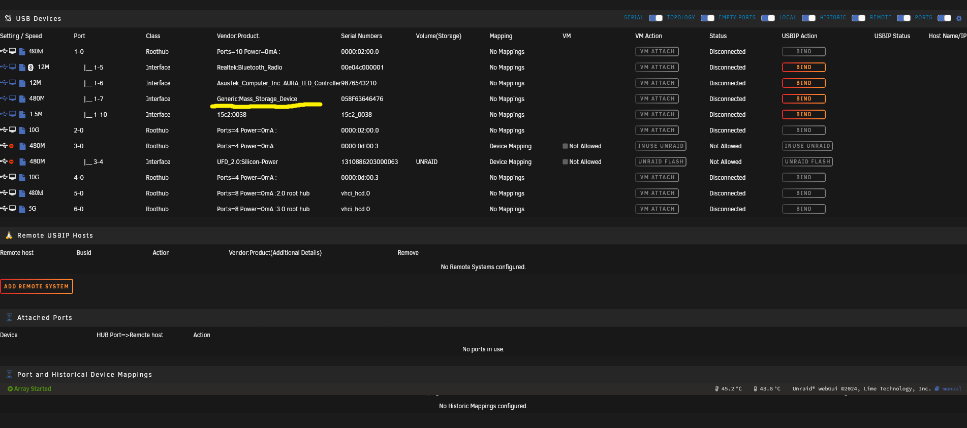

Was the keyboard and mouse selected to be on server? Does lsusb -t show any additional data
You can run lsusb to get bus/dev id then lsusb -vvs bus:Dev for the device on 1-7

However, my mouse won't work unless it's plugged in directly to the Unraid NAS. Any devices I plug into the KVM won't pass through for some reason but those same devices will work if plugged directly into the Unraid NAS.
