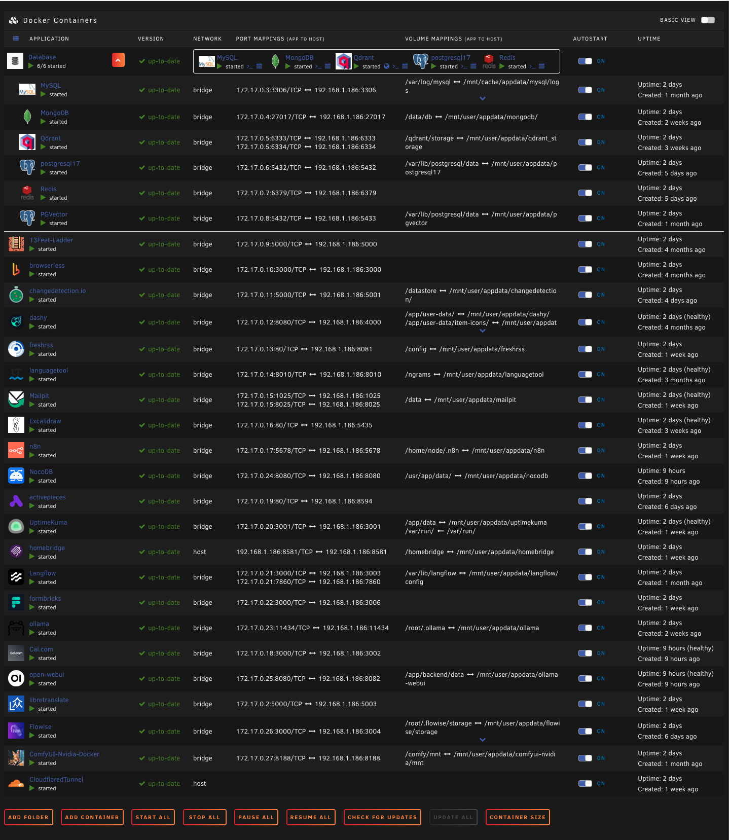

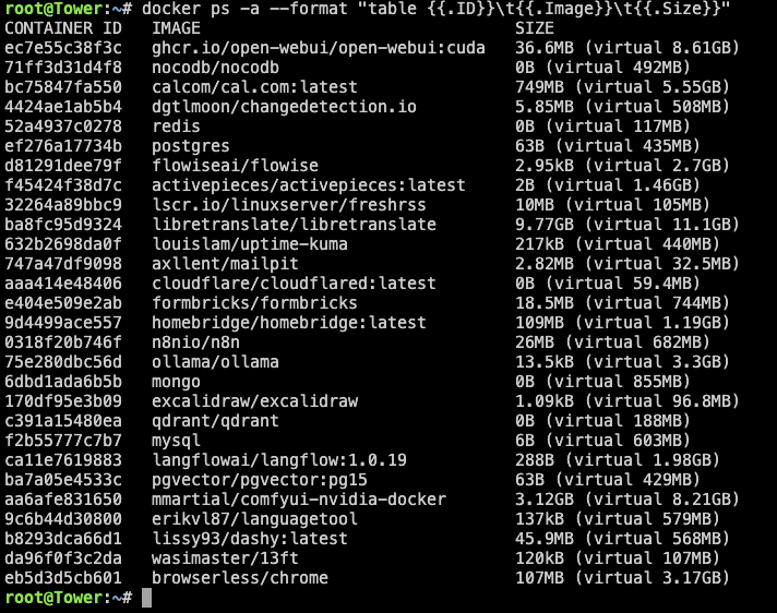

@itimpi 20GB Was running low for my docket.img file:

OK - but why jump it all the way to 160GB?
Note that one classic reason for a docket.img file running out of space is a container mis-configured so that it writes files internally to the image instead of a location mapped to the host.
First time I have heard of needing one that big but I guess it is possible if running certain container mixes.
