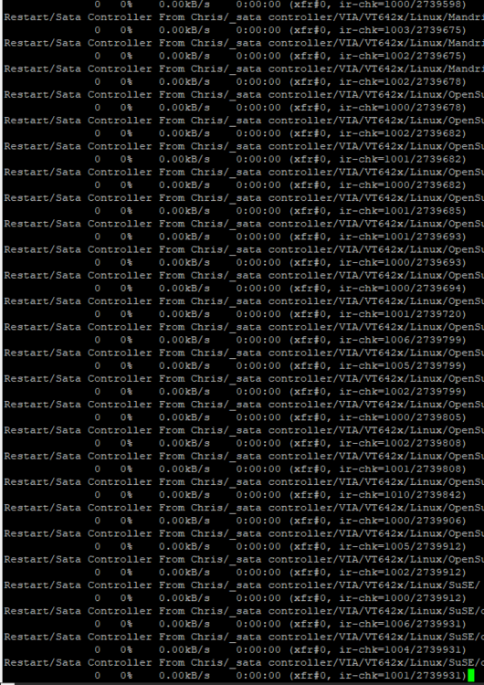

I'm running rsync on a target Unraid server to pull data from a source Unraid server.  Running rsync once after a fresh reboot works without issue.  Subsequent rsync calls slow down and stop at 0kbps.
The source dataset is ~7tb without compression, and the target server has previously successfully completed full syncs, and is running zstd-9 compression.
Both unraid servers are 6.12.14.  Source is an i7-4770S w/32gb of DDR3, and target is a i5-13600k, with 96gb DDR5.
Rsync is run on the target server.
Rsync command:
rsync -avzhP --info=progress2 root@server:/mnt/liveFiles/ /mnt/ur2pool/hotBackup/
This is what I see 20 min after running the above command after having completed the same call successfully earlier this evening:

UPDATE:  Ok, even a reboot isn't solving it any longer.  I'm starting to think this may be a physical problem.  This is 5 min after calling rsync after a fresh reboot of both source and target servers, and a reboot of the Mikrotik switch, and ER-x router:
And 5 min after that screenshot:
Those two files being synced are the two diag files attached to this post.
Subsequent attempts without rebooting anything are even worse:
Target network:
Source network:
Any thoughts as to how to resolve this?

Looks like I spoke too soon on my last post.  It did start, and started with transfers at ~14MBps, but has promptly slowed down to ~2MBps, and is slowly going slower over time...Now at ~1.9MBPS:
And now ~30 min later, speeds have picked up:
Given I'm getting faster speeds with the UD share, does that provide any insight into why the SSH copy was so slow?  Any thoughts on the inconsistency I'm seeing all over the place?
Thanks again for all your help and insight as always @JorgeB,
Cal.
Sorry for the multiple posts.  I'm confused by what I'm seeing, and am not making any progress on solving this issue.  0%, and 0kbps for everything?  WTH?
Is the copy still going? Very small files can show basically null stats
It completed after quite some time.  Restarting show slow transfers even on larger .iso or VM files.  :(
