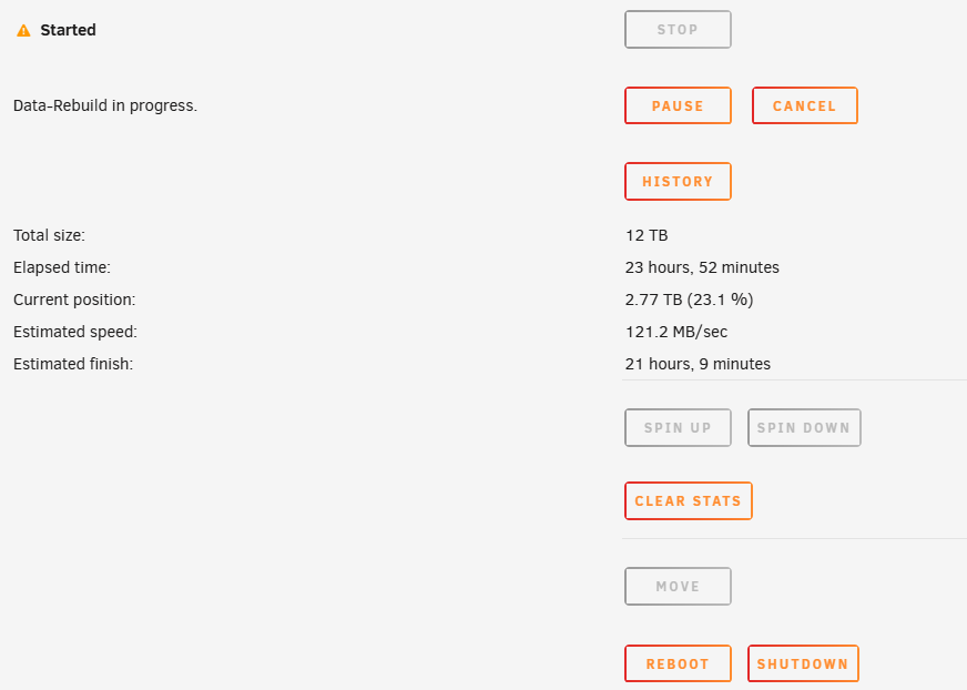

I've been having some random issues lately with one drive (disk 4), it went unmountable then I had severally days of messing around to get it resolved but eventually the array recovered. However a day ago a different disk dropped (disk 1) and went to emulated so I started a rebuild, the disk dropped right when many automated processes all started at the same time (parity check, appdata backup, mover) so I hoped it was just a random error so I got the disk rebuilding.
The rebuild was going, it was slow but doable so I was going to let the rebuild complete then figure out what might have been going on perhaps physically, (I'm thinking maybe power supply as the power supply is fairly old and the first issue happened after the server power cord got accidently pulled) but partly through the rebuild the parity drive threw a bunch of errors and now I have a feeling I just lost that drive.
I'm not sure what I can do to recover, everything is still running right now but obviously nothing on that drive that was rebuilding is accessible, and the parity drive is showing up in unassigned devices.

Should I shutdown and turn back on? the UI wont let me change anything in the state its in, and canceling the rebuild does not change anything.
Type powerdown in the CLI, if it doesn't shutdown after 5 minutes, you will need to force it.
