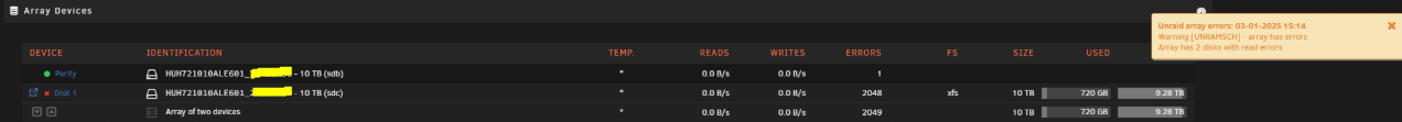

First the parity check had a slim 180k corrections at ~60% and now it has completely stopped a few hours in giving me a read error

There are constant ata errors with parity and disk1, looks more like a cable/connection problem, do they share a power splitter or similar?
yes, they are both plugged into the mainboards sata power supply using a Y splitter.
But i hotglued that thing in as it was quite loose
Edited by cottec
Try again, if issues persist replace the splitter.
Yeah, that might be necessary then.

I cleared both disks now, no issues during the pre read, clear and post read. wasn't a productive system anyways, so all is fine for the moment.
Thanks!
My mistake was overlooking the checked checkbox to correct parity issues during manual parity check. That killed my parity + I had no confidence in the data stored on the data disk due to the read errors.
