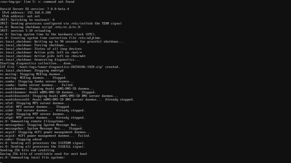

Stuck at "Unmounting local file systems:" after ZFS pool got "SUSPENDED"
I have one RaidZ1 pool with 3 HDDs, recently one is supposedly dead (usually after rebooting it kinda works for some time), anyway, with this pool suspended Unraid doesn't turn off or reboot, it stops at "Unmounting local file systems:" requiring manually to shut it down.

1 hour ago, Chriexpe said:
pool suspended
After this happens, you will have to force a reboot, there were errors with 2 disks, I assume at the same time for the pool to get suspended, it's a zfs issue, not way around it AFAIK, reboot and run a scrub, but if there are two bad disks, the pool will suspend again.
I'm aware, but shouldn't Unraid be more "resilient" to it (like not depending on disks)? It hangs during reboot/shutdown and I have to manually reset the server (thank god I have PiKVM).

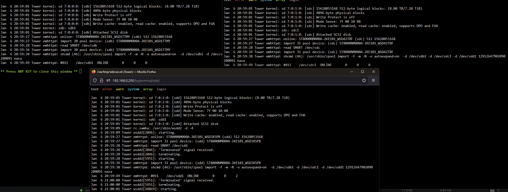

Also, please take a look at diagnostics, specifically at syslog-previous as Unraid just mysteriously died some hours after the ZFS pool getting suspended, there wasn't any log or video output at all, I've read even some error with my SAS card too.
Interestingly enough, after a fresh reboot everything works fine (note that there is a NVR recording to this pool 24/7), tho one disk (sdd) lags behind in R/W.
Not only that but looking at the logs, that disk (sdd) has some more log that I couldn't comprehend right.
Do you have any idea on what could be? If it's actually one disk failing I may be able to get warranty on it (all HDDs are identical, Seagate Exos 7e8 8TB).
