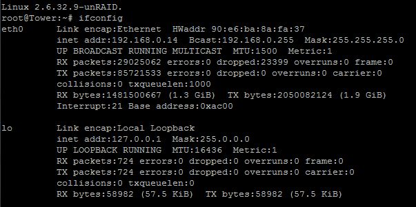

Here's my ifconfig. Sorry, I didn't know how to output it to a text file.

23399 DROPPED packets pretty much tells you the link is not working as expected.  There should be NO dropped packets.

Sorry... the ifconfig that I posted awhile back is AFTER I did all the changes... and the problem is still there... :'(
