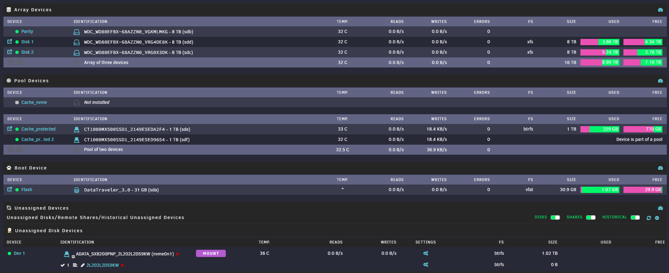

And my Docker (1TB XPG 8200 Pro) started having issues after just 2.5yrs of running and I had to remove it and move docker to another pool.

I want to do 2x NVMe to have some redundancy, as it was a huge pain to get the docker data moved to a different pool when the drive's segments are failing 😅

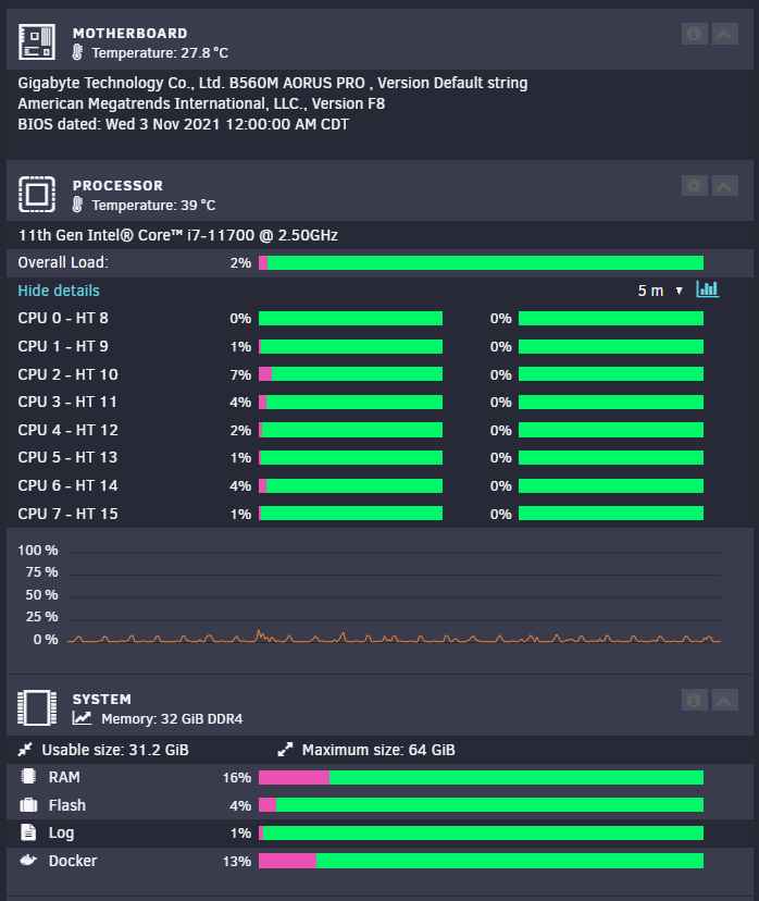

This is the full setup I'm running:
CPU: Intel i7-11700
MB: Gigabyte B560M AORUS PRO
RAM: 32 GB DDR4
3x 8TB HDD for the Array - WD Red
1x 1TB NVMe for Docker and unprotected cache - XPG 8200 Pro
2x 1TB SSD for protected cache - Crucial MX500
