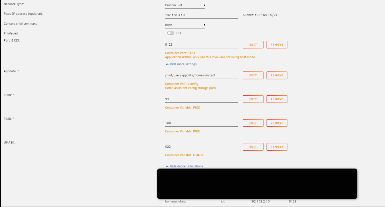

I try tu use a second nic for one docker and it is not working.
I did an interface in the docker network
When i try to assign an IP in the docker setting

I don't think you can do that.
What's your goal?
what's your network(s) ?
if your Unraid network is 192.168.1.0/24 the bridge can't be the same network.
you can create a sub interface on a vlan and create a macvlan network with the sub interface as parent.
or you can add a second Nic in another network and create a bridge network on that Nic.
You can also create a macvlan network on the Unraid host network but you need to pay attention to not overlap DHCP range.
But 2 Nics in the same network on the same host don't play well.
