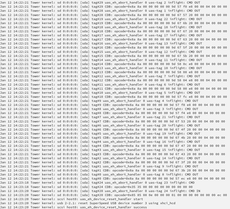

After 7.0.0 was installed, I wanted to make a new backup of the important parts of the server to my external USB 8TB backup HDD (rather new Seagate Exos type) as usual... (using famous rsync script of @mgutt)
However with the new system it doesn't work any more or is so slow, that the  it is useless...
Here is a typical message of syslog... it goes like this over thousands of lines in the syslog:

It's a Seagate disk but not a Seagate enclosure, right? Also, post the output from
lsusb -t

Yes, it is a bare Exos harddisk but not a Seagate enclosure/product which contain the harddisk.
So lsusb -t returns:
root@Tower:~# lsusb -t
/:  Bus 001.Port 001: Dev 001, Class=root_hub, Driver=xhci_hcd/16p, 480M
    |__ Port 003: Dev 009, If 0, Class=Hub, Driver=hub/4p, 480M
    |__ Port 007: Dev 003, If 0, Class=Hub, Driver=hub/4p, 480M
        |__ Port 002: Dev 005, If 0, Class=Mass Storage, Driver=usb-storage, 480M
    |__ Port 011: Dev 004, If 0, Class=Human Interface Device, Driver=usbhid, 12M
/:  Bus 002.Port 001: Dev 001, Class=root_hub, Driver=xhci_hcd/10p, 20000M/x2
    |__ Port 003: Dev 008, If 0, Class=Hub, Driver=hub/4p, 5000M
        |__ Port 001: Dev 009, If 0, Class=Mass Storage, Driver=uas, 5000M
        |__ Port 002: Dev 010, If 0, Class=Mass Storage, Driver=usb-storage, 5000M
root@Tower:~#

Possibly, that enclosure doesn't like the UASP driver, try adding the below to syslinu.cfg for your default boot mode:
usb_storage.quirks=152d:9561:u
After /bzroot, then reboot
your advice solved my problem...
excellent support!
