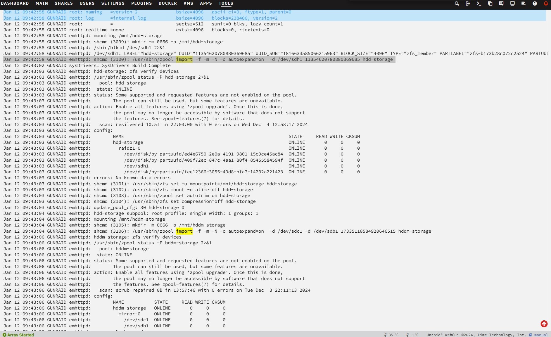

I've upgraded from 6.11.5 to 7.0, and after a lot of debugging here is what I see is happening. Everything works, but the UI shows my 4-drive RAIDZ1 incorrectly. The reason is because it maps the /dev/sdh1 drive in the UI but not the /by-partuuid/ drives. In the syslog, the zfs import command only includes /dev/sdh1 . You can see for the "hddm-storage" mirror import command it includes both /dev/sdc1 and /dev/sdb1 .
I figured out that it simply needs to import the pool like this "zpool import -d /dev/disk/by-id <pool-name>" but it doesn't and i can't force it to. The best I was able to do was start a new config with just the hddm-storage and not the hdd-storage 4-drive RAIDZ1, and manually import hdd-storage with "-d /dev/disk/by-id" , THEN add the pool, and THEN the UI shows all 4 drives BUT to the right it says "unable to mount this pool" so it's bugged THAT way instead.

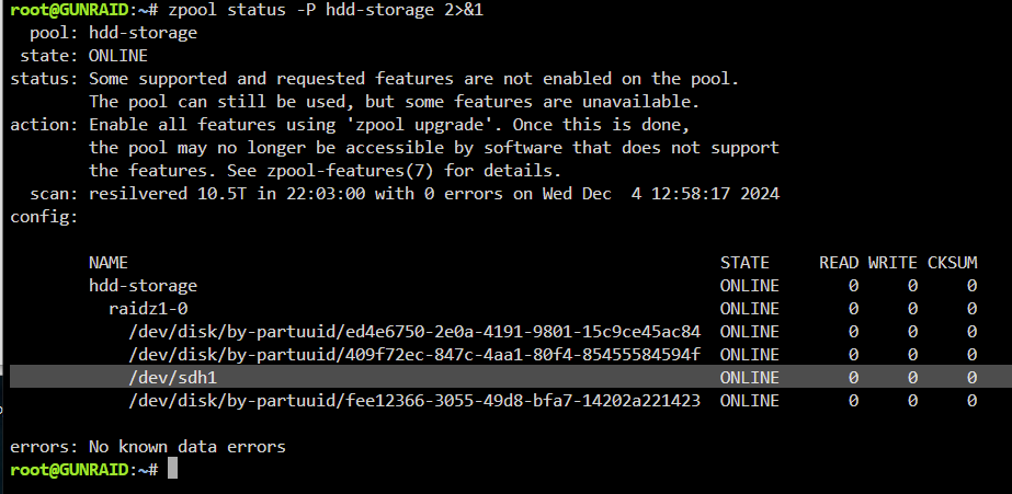

Sdh is different because it is the drive that failed and i had to replace back under 6.11.5 i did a manual replace with another disk and it ended up going by dev/sdh instead of partuuid.
i can’t recreate the whole pool. Should be possible to remove the drive and add it back as a new drive but by its by-partuuid. It would have to resilver all over again. Would that work, Does unraid just want them all by partuuid?

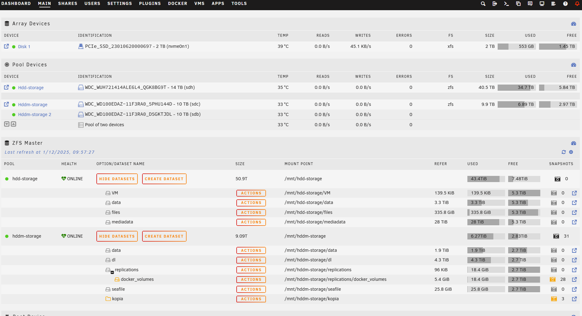

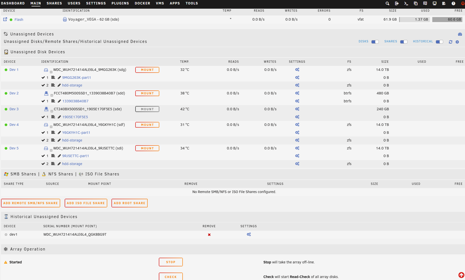

It works, it’s the UNRAID UI that displays it weird. My mirror says “this is a pool of 2 drives”, but the RAIDZ1 just shows the single sdh drive and the other 3 show up under “unassigned”
