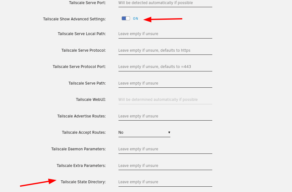

January 13, 20251 yr Solution 7 minutes ago, ronschaeffer said: For every one that I've tried, the log reports What containers are you using/trying? You can always specify the state directory manually here by opening the Advanced Settings in the Tailscale settings: This state directory should always reflect the persistent directory inside the container like here "/data": So to speak in this example the state directory should be "/data/.tailscale_state":

January 13, 20251 yr 5 minutes ago, ronschaeffer said: I tried Flame again after FileBrowser succeeded. Same error. I updated my post above, however for FileBrowser the state directory should be: /database/.tailscale_state and for flame_cloudfare the state directory should be: /app/data/.tailscale_state Sadly enough it is not always possible to auto detect the state directory that's why you have to specify it manually. Linuxserver.io, Binhex and of course my containers should be fully compatible and detect the path always automatically. Hope that helps.

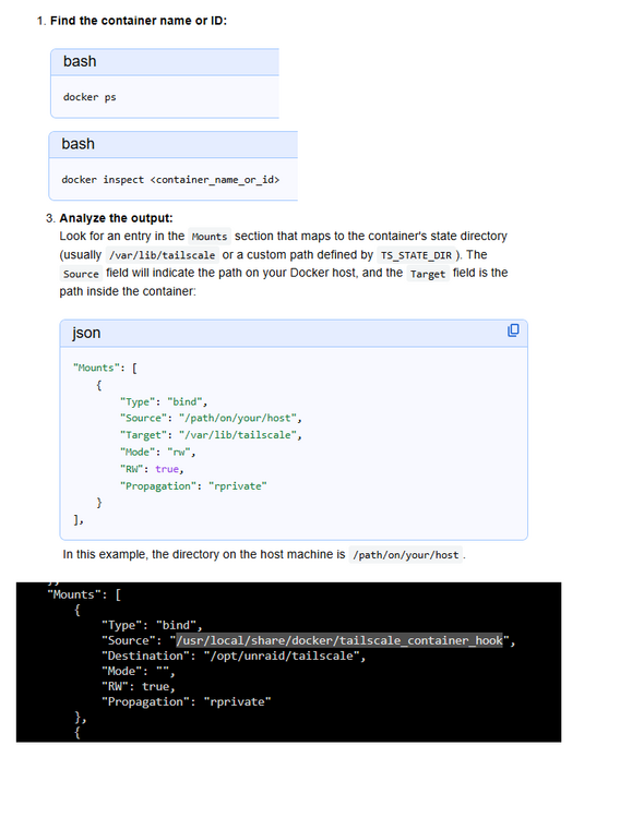

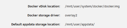

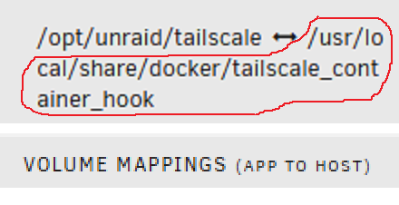

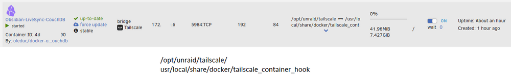

January 16Jan 16 On 10/26/2025 at 1:59 AM, omninewb said:you need to set the Tailscale State Directory for a location in your container.I installed this docker (docker-obsidian-livesync-couchdb)ERROR: Couldn't detect persistent Docker directory for .tailscale_state!Please enable Tailscale Advanced Settings in the Docker template and set the Tailscale State Directory manually!Not sure how to figure out my Livesync-CouchDB docker container's Tailscale State directoryDocker container data:/opt/unraid/tailscale/ <-> /usr/local/share/docker/tailscale_container_hookthe default appdata storage location for my dockers is: /mnt/user/appdata/but I dont see a obsidian-livesync-couchdb in thereI see: obsidian/ qbittorrent/ syncthing/ youtube-audio/ youtube-subscriptions/ youtube-video/ youtubedl-material/I can't seem to find where my couchDB is.I found the docker containers: /var/lib/docker/containersI found the appropriate location via this:I think the answer is easier:in your list of docker containers:http://192.168.1.xx/Docker use the volume mapping I have circled in red.Note: that was show in my first image in the post. Edited January 16Jan 16 by digitaldoctor
