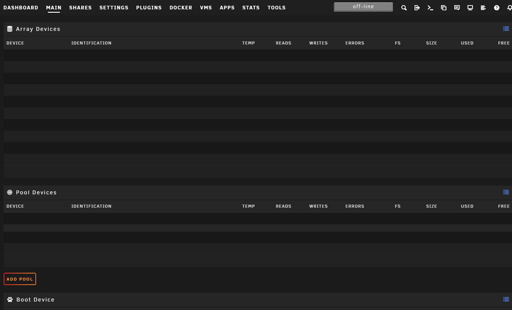

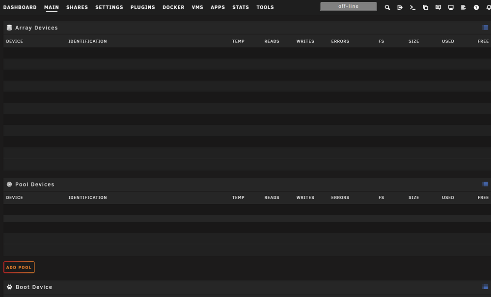

I upgraded to 7.0.0 last night, and I now have a problem.
I don't see any drivers in the UI and I can't start the array.
But I have the "Disk Location" plugin, and that DOES show the drives.
#weird.
I don't know how to move from here, any advice ?
PS. This is what I am looking at right now:

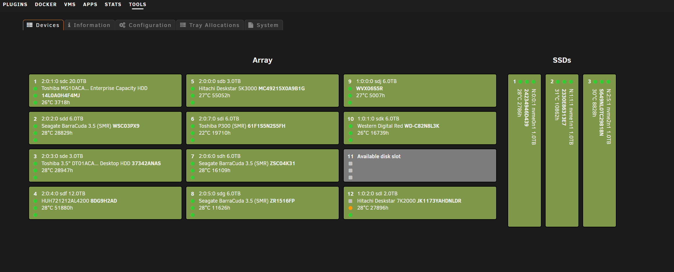

Although Disk Location:
