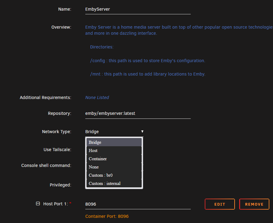

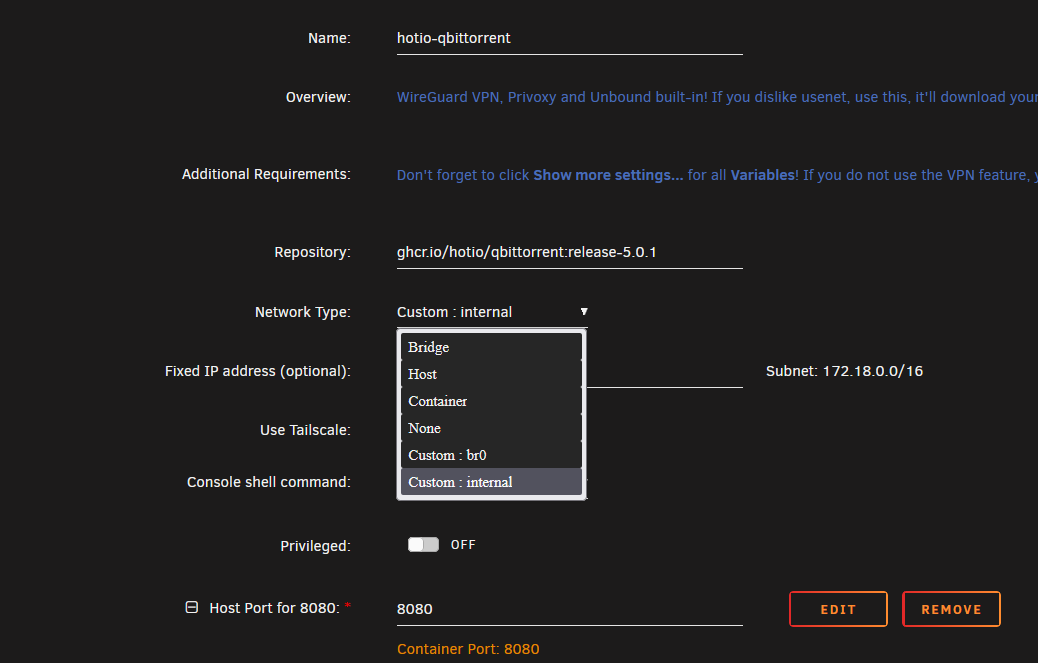

I forgot to mention that I deleted the custom network and remade it with the same name. The containers threw errors when starting so I made dummy changes to each containers "network type" (change it from my custom network > bridge > back to custom network) and that allowed them to be started.

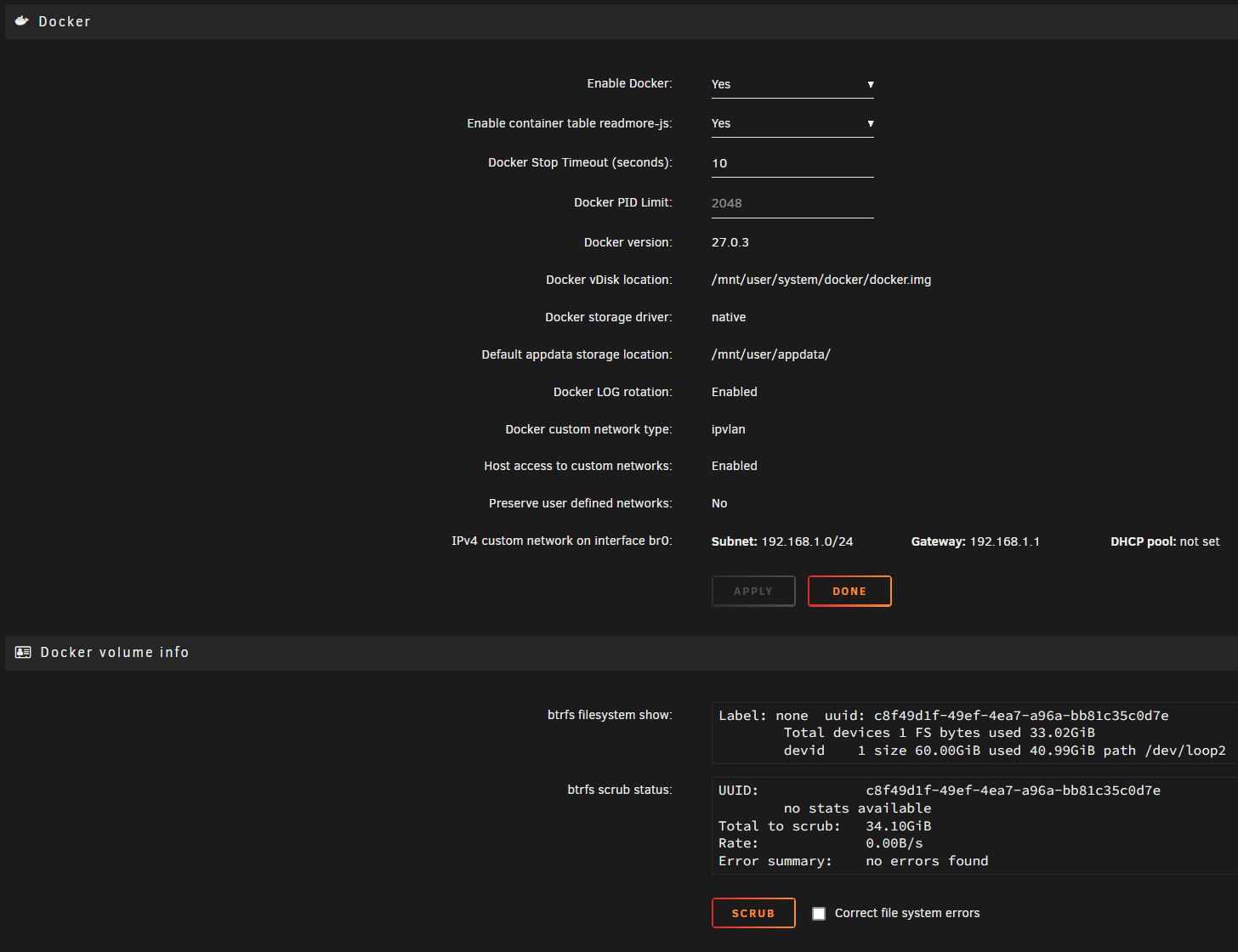

"Preserve user defined networks" was set to no, so I've changed that to yes. However it is still behaving the same way.
