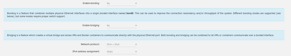

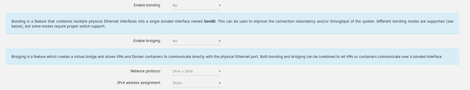

SO, In unraid 7 I run:
a single nic with ipv4 and ipv6. Since I have only 1 Nic I have no use for bridging nor bonding. So I turn them off. My interface eth0 supports macvlan without the need to use a software network br0... (there was a while and time of some nic and hardware not able to support macvlan due to needing to support other nic settings....)

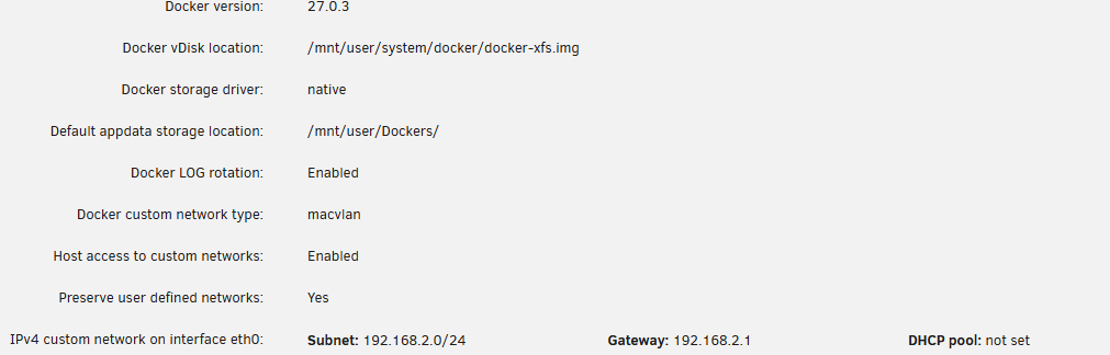

Docker settings:
*Due to the Macvlan bug, and some Nic Hardware requirments, I can see why the switch to ipvaln...
I still Prefer Macvlan due to the interaction of each docker service I run will have its own Mac address. (And having the ability to assign a mac my self)
*Due to docker evolution contains can no longer set their own mac this is now done at the docker network level...
For My network, I Want to Preserve User Defined Networks for other docker networks I create.
I Want Host access to custom Networks Enabled to allow my docker to talk to the subnet and lan network over eth0

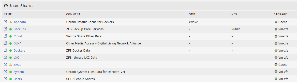

With unraid v7 I prefer a xfs img base for stability. With ZFS implementations, this may need to become an overlay 2...

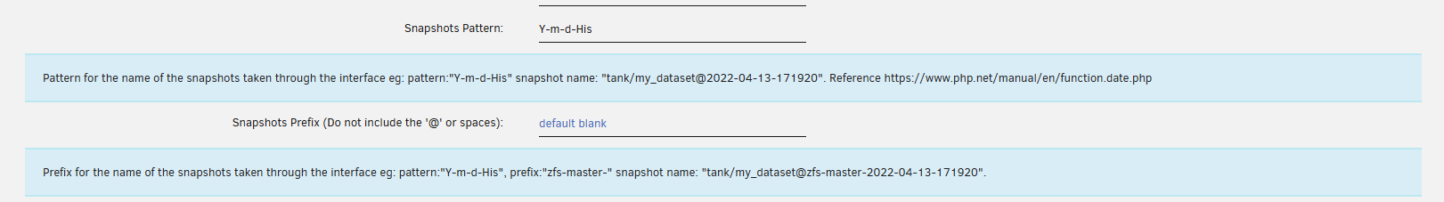

with ZFS Master Plugin and Snap shots plugin we can double-check:
Additional ZFS Master Plugin Settings:
*As the level1 Guide used https://github.com/zfsonlinux/zfs-auto-snapshot/wiki/Samba for making zfs snapshots... I'm accomplishing this via a different script and differnet file name.
Using the ZFS Mast Plugin you can add a Snapshot Prefix and still follow along Level 1 guid to a point...

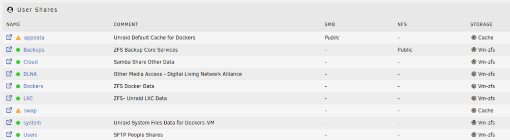

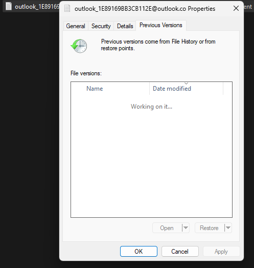

So Now that we have some snapshots:
we can double-check with the snapshot plugin or terminal:
 root@BMM-Unraid:~# ls /mnt/user/Cloud/.zfs/snapshot
2024-12-23-1840/  2024-12-28-1735/  2024-12-29-0206/  2025-01-05-0408/  2025-01-19-1637/  2025-01-19-1754/
lets run and make sure the snapshots are visible.

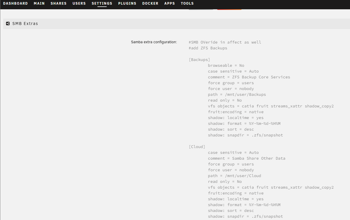

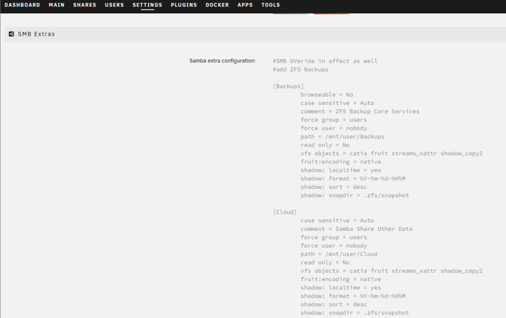

zfs set com.sun:auto-snapshot=true vm-zfs/Cloud
zfs set snapdir=visible vm-zfs/Cloud
With ZFS Implementations and snapshots ready we are now set to edit Samba...
For Personal Reason and for Advance configurations. I Decided to Forgo Unraid SMB conf.
I use a script to stop samba, remove smb.conf and replace unraids smb.conf with my own...
Script:

smb override:
root@BMM-Unraid:~# cat /boot/config/smb
smb-extra.conf     smb-override.conf  smb.conf           smbpasswd
root@BMM-Unraid:~# cat /boot/config/smb-override.conf
[global]
# Configurable identification disabled as we need to make other edits.
# include = /etc/samba/smb-names.conf
# Generated names
netbios name = BMM-Unraid
server string = Unraid NAS Server
workgroup = WORKGROUP
security = USER
map to guest = Bad User
guest account = nobody
null passwords = Yes
# Network settings
wins support = yes
name resolve order = lmhosts wins bcast host
multicast dns register = Yes
disable netbios = No
bind interfaces only = yes
interfaces = 192.168.2.254/24 127.0.0.1
# Master browser settings
server role = standalone server
local master = yes
domain master = yes
preferred master = yes
os level = 200
nmbd bind explicit broadcast = no
# Logging
logging = syslog@0
# log level = 3
# File and directory permissions
create mask = 0777
directory mask = 0777
acl allow execute always = Yes
# Printer settings
show add printer wizard = No
disable spoolss = Yes
load printers = No
printing = bsd
printcap name = /dev/null
# Performance settings
aio read size = 0
aio write size = 0
use sendfile = Yes
server multi channel support = yes
max open files = 40960
# Miscellaneous settings
invalid users = root
fruit:encoding = native
fruit:zero_file_id = false
fruit:nfs_aces = No
rpc_server:mdssvc = disabled
rpc_daemon:mdssd = disabled

Due to Samba Shares Settings need updated I use terminal command to get my current samba shares and remvoed Unraid WebUI from messing them.
Note I still have atleast 1 share that doesn't have zfs backups...
Since I needed to reboot I edited the config instead of stopping the array to add my shares to Samba Extra...
Example Share:
root@BMM-Unraid:~# cat /boot/config/smb-extra.conf
#SMB OVeride in affect as well
#add ZFS Backups
[Cloud]
        case sensitive = Auto
        comment = Samba Share Other Data
        force group = users
        force user = nobody
        path = /mnt/user/Cloud
        read only = No
        vfs objects = catia fruit streams_xattr shadow_copy2
        shadow: localtime = yes
        shadow: format = %Y-%m-%d-%H%M
        shadow: sort = desc
        shadow: snapdir = .zfs/snapshot
Note the Format, This needs to match your ZFS Master Plugin and Prefix and teh way your zfs snapshots are made for its file name! I don't have a prefix. and using the format per my snapshots
Reboot to apply...
Thats it. With samba now working by going to my Unriad IP for testing:
With that I Now have zfs snapshots working as shadow copies.
As its easier to see with documents when documents are edited and changed and a snapshot of its revios is different:
RMC>Properties Previous Version:
You will see a earlier revision via Shadow Copies.
