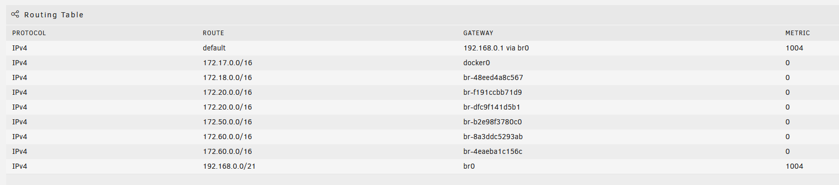

Anyway I think my network settings are seriously wrong. I mean, I have duplicate Routes, that doesn't right to me.

I don't see a issue for your routes...
Each BR-#### is a docker that is using that network bridge.

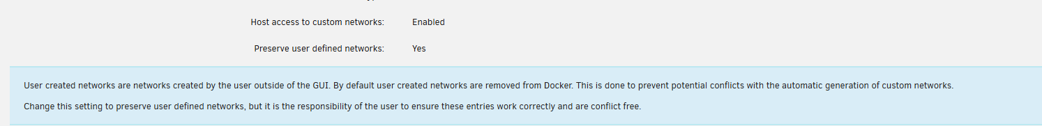

"Preserve user defined networks" is set to YES, "Host access to custom networks" is set to NO and Network type is ipvlan

-- This Means that if you have a docker with port 8080 in use on nirvnet it can't be in use across the default docker --
Example: Bind nirvnet Container to a Specific Host IP
docker run --name nirvnet-container \
  -p 192.168.10.1:8080:8080 \
  --network nirvnet \
  <image>
Step 5: Configure Host-Based IP Routing (Optional)
*In your case a must to access and grant routes...
sudo ip route add 192.168.10.0/24 via 192.168.10.1
sudo ip route add 192.168.20.0/24 via 192.168.20.1
*This is where a swag / npm proxy running host network makes sense to have multiple access from one ip...
Step 6: Test the Setup
Verify access to each network:
For a container in nirvnet, navigate to http://192.168.10.1:8080.
For a container in automation_tools, navigate to http://192.168.20.1:9090.
If routing or access fails, double-check the assigned IPs, Docker network settings, and any existing firewall rules.
As you have multiple dockers uisng the same ports from teh same ip I'm not surprised that you are unable to access via the default bridge...

Well, turns out all these strange extra routing table entries were the issue.
Delete them with ip link delete <interface name>
And done.
I'll further expand on what I did to finally fix my issue for completeness sake:
After I saw i had a bunch of br-**** Routing Table entries in the "Network Settings", i opened the console and typed
ip addr show
docker network ls
To show all my interfaces and docker networks and noted them down.
I then deleted every non-default docker network with `docker network rm {network name}`
docker network rm {network_name}
After that I did the previous two commands again and I manually deleted all the br-*** interfaces left.
ip link delete br-{interface name}
Until you are with just your lo, tunl0, br0, eth0 and docker0. Depending on your configuration you should not have anything else.
Then create your docker network again.
docker network create --driver bridge --subnet=172.20.1.0/16 --gateway=172.20.0.1 --ip-range 172.20.1.255/16 {network_name}
And now the shitty part: go to each container through the UI, change the network to none, save, go back, change the network to {network_name} and save again. I had to do this to my 33 containers.
There might be a command to do this through the command line but I'm not aware of it, if there is a way and anyone knows, I'll update this to reflect that. Maybe "docker network connect {network_name} {container_name}" works but I didn't personally try.
That fixed it for me. I hope this helped.
