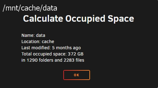

While I can't say for certain, I do believe all of these files in /mnt/cache/data are created by qBittorrent

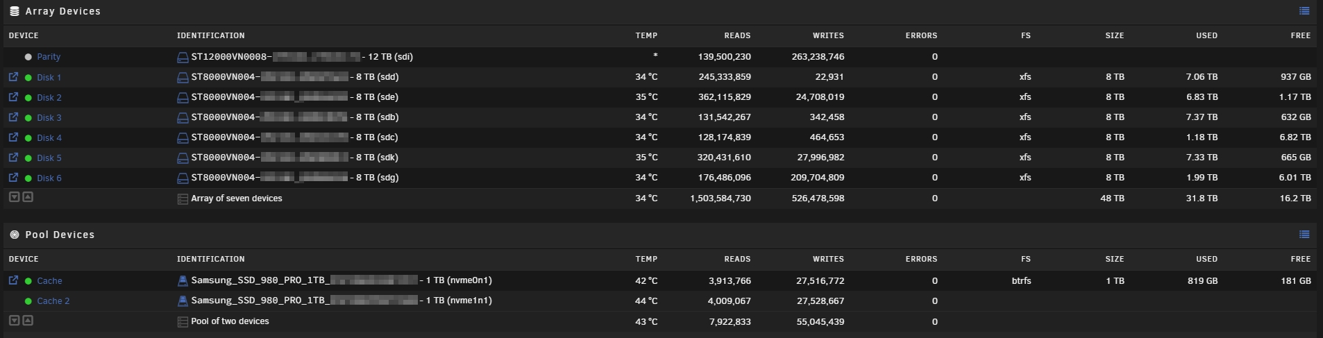

Cache is using 818GB of 1TB, of which 372GB is legally obtained Linux ISO's.

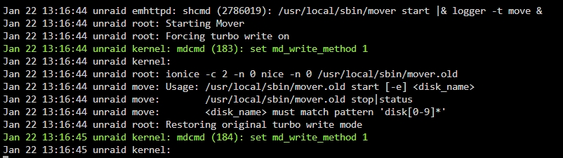

This is the log entry when mover is initiated
Jan 22 13:16:44 unraid emhttpd: shcmd (2786019): /usr/local/sbin/mover start |& logger -t move &
Jan 22 13:16:44 unraid root: Starting Mover
Jan 22 13:16:44 unraid root: Forcing turbo write on
Jan 22 13:16:44 unraid kernel: mdcmd (183): set md_write_method 1
Jan 22 13:16:44 unraid root: ionice -c 2 -n 0 nice -n 0 /usr/local/sbin/mover.old
Jan 22 13:16:44 unraid move: Usage: /usr/local/sbin/mover.old start [-e] <disk_name>
Jan 22 13:16:44 unraid move:        /usr/local/sbin/mover.old stop|status
Jan 22 13:16:44 unraid move:        <disk_name> must match pattern 'disk[0-9]*'
Jan 22 13:16:44 unraid root: Restoring original turbo write mode
Jan 22 13:16:45 unraid kernel: mdcmd (184): set md_write_method 1

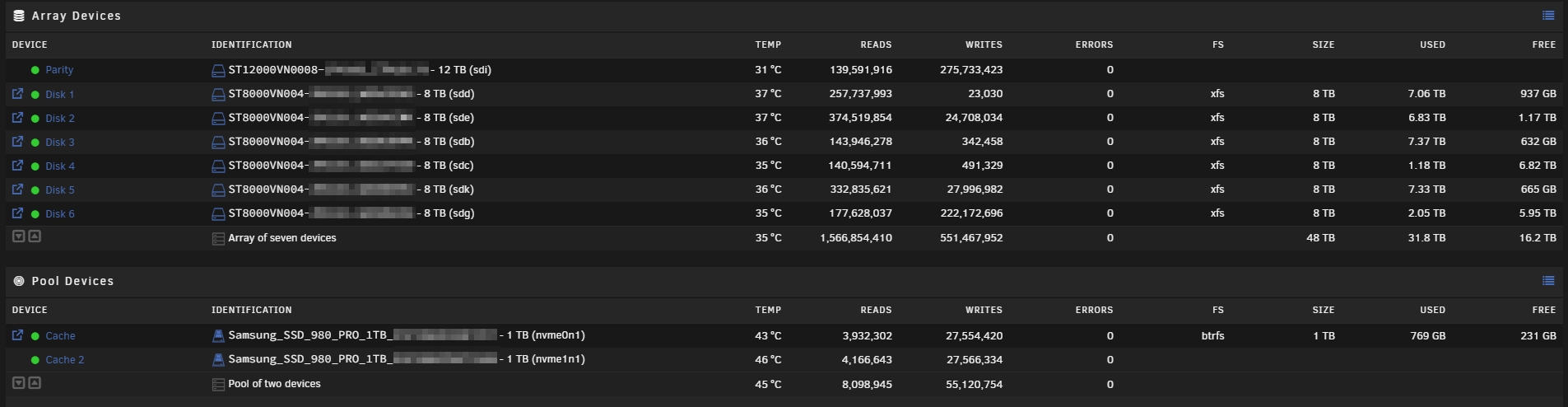

Cache utilization is shrinking

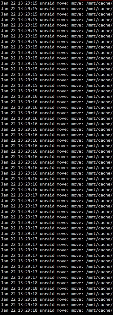

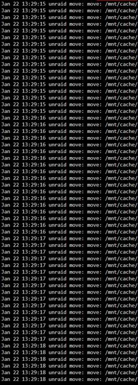

Log shows mover is moving
Array writes are increasing
