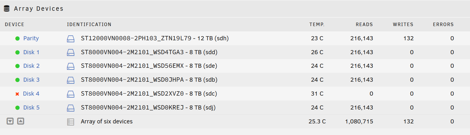

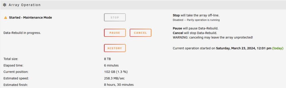

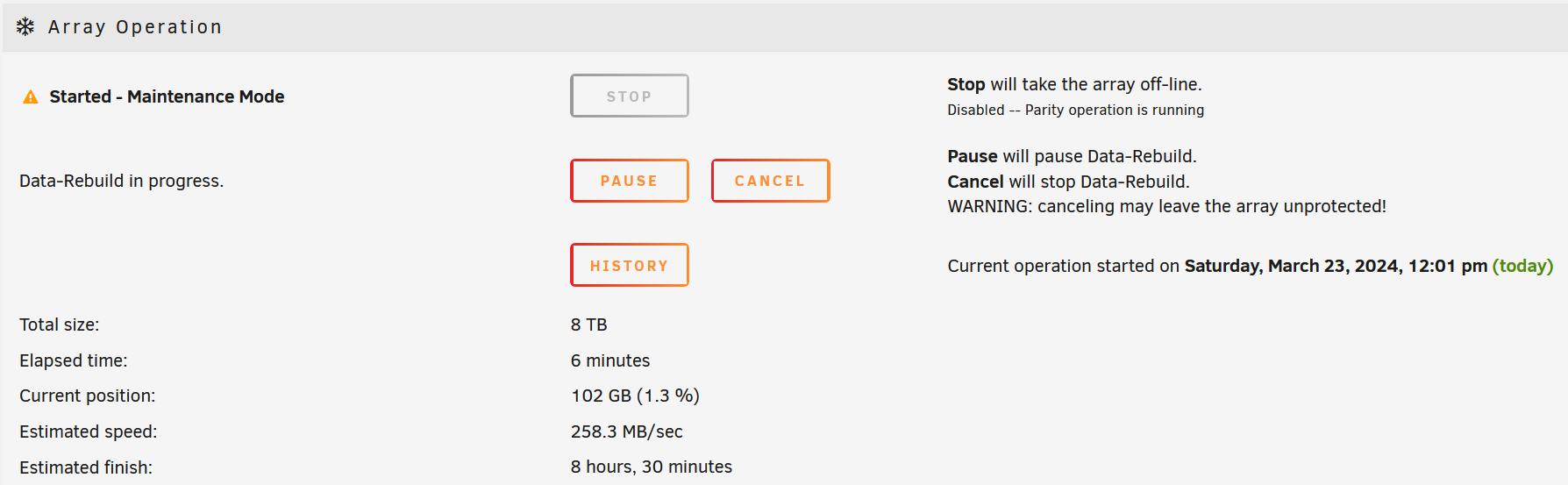

  4. For anyone just coming across this issue, this is what I did to fix it. Array was started in Maintenance Mode I ran the following commands outlined below taken from this post linked below relating to Seagate Ironwolf disks and LSI HBA cards due to a drive showing disabled contents emulated These are my mappings only related to Seagate Ironwolf Drives Only I pasted the output from sg_map into notepad, and made notes as to what the sg_map output relates to which drive in my array and it's use (Parity and Data) just for my own record keeping root@unraid:/tmp/SeaChest# sg_map /dev/sg7 /dev/sdh Parity /dev/sg2 /dev/sdc Data Array (drive that was disabled) /dev/sg3 /dev/sdd Data Array /dev/sg4 /dev/sde Data Array /dev/sg1 /dev/sdb Data Array /dev/sg9 /dev/sdj Data Array The SeaChest folder structure is different than noted in the link above, Seagate seems to change this more often that I think they should (IMO) This is the folder structure as of 2024-03-23 C:\USERS\JAY\DOWNLOADS\ └───SeaChestUtilities ├───doc ├───Linux │ ├───Non-RAID │ │ ├───aarch64 │ │ └───x86_64 │ └───RAID │ ├───aarch64-RAID │ └───x86_64-RAID ├───parallel_testing ├───USB boot maker └───Windows ├───Win64-Non-RAID └───Win64-RAID These are files I will be working with. They reference alpine linux in the name, but when made executable they worked perfectly on unraid. C:\USERS\JAY\DOWNLOADS\SeaChestUtilities\Linux\Non-RAID\x86_64\ Mode LastWriteTime Length Name ---- ------------- ------ ---- -a---l 2024-03-19 3:33 PM 657216 SeaChest_Basics_x86_64-alpine-linux-musl_static -a---l 2024-03-19 3:33 PM 616256 SeaChest_Configure_x86_64-alpine-linux-musl_static -a---l 2024-03-19 3:33 PM 706432 SeaChest_Erase_x86_64-alpine-linux-musl_static -a---l 2024-03-19 3:33 PM 600168 SeaChest_Firmware_x86_64-alpine-linux-musl_static -a---l 2024-03-19 3:33 PM 628544 SeaChest_Format_x86_64-alpine-linux-musl_static -a---l 2024-03-19 3:33 PM 595808 SeaChest_GenericTests_x86_64-alpine-linux-musl_static -a---l 2024-03-19 3:33 PM 712896 SeaChest_Info_x86_64-alpine-linux-musl_static -a---l 2024-03-19 3:33 PM 583488 SeaChest_Lite_x86_64-alpine-linux-musl_static -a---l 2024-03-19 3:33 PM 612160 SeaChest_NVMe_x86_64-alpine-linux-musl_static -a---l 2024-03-19 3:33 PM 608064 SeaChest_PowerControl_x86_64-alpine-linux-musl_static -a---l 2024-03-19 3:33 PM 554816 SeaChest_Reservations_x86_64-alpine-linux-musl_static -a---l 2024-03-19 3:33 PM 653184 SeaChest_Security_x86_64-alpine-linux-musl_static -a---l 2024-03-19 3:33 PM 853856 SeaChest_SMART_x86_64-alpine-linux-musl_static From Windows 11 Terminal I opened 2 terminal tabs (I use ssh keys for access to all my Linux servers) TAB1: (Keep tab open after running these commands) ssh into unraid server and create a folder in /tmp called SeaChest ssh unraid mkdir /tmp/SeaChest TAB2: Copy all the SeaChest utilities over to unraid in /tmp/SeaChest from the download location using scp command scp C:\Users\jay\OneDrive\Downloads\SeaChestUtilities\Linux\Non-RAID\x86_64\* unraid:/tmp/SeaChest TAB1: mark the files copied to unraid as executable chmod +x /tmp/SeaChest/* I disabled EPC as well as the lowCurrentSpinup (just to be safe but as noted in the link, not confirmed if necessary) go to /tmp/SeaChest folder and run the 3 utilities below The first command will verify on /dev/sg2 (my problem disk) that epc is enabled Second command will disable EPC on /dev/sg2 Third command will disable lowCurrentSpinup (not sure if this is actually needed but ran it regardless) ./SeaChest_Info_x86_64-alpine-linux-musl_static -d /dev/sg2 -i |grep -i epc ./SeaChest_PowerControl_x86_64-alpine-linux-musl_static -d /dev/sg2 --EPCfeature disable ./SeaChest_Configure_x86_64-alpine-linux-musl_static -d /dev/sg2 --lowCurrentSpinup disable I ran those commands above for all of the /dev/sgX disks that were Seagate Ironwolf connected to my LSI card. --- Once that portion was completed, I followed the guide below to rebuild the drive from parity There was one caveat, for some reason I could not stop the array while it was is maintenance mode. It kept saying Retry Unmounting Shares (for about 40 minutes) so I did a powerdown from terminal powerdown Once the server came back up I did the following procedure outlined in the guide linked below (TL;DR) Stop array Unassign disabled disk Start array so the missing disk is registered Stop array Reassign disabled Disk (the symbol turned to a blue square) Start array in maintenance mode Clicked Sync button to rebuild the disk from parity https://docs.unraid.net/unraid-os/manual/storage-management/#rebuilding-a-drive-onto-itself

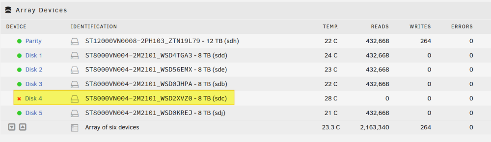

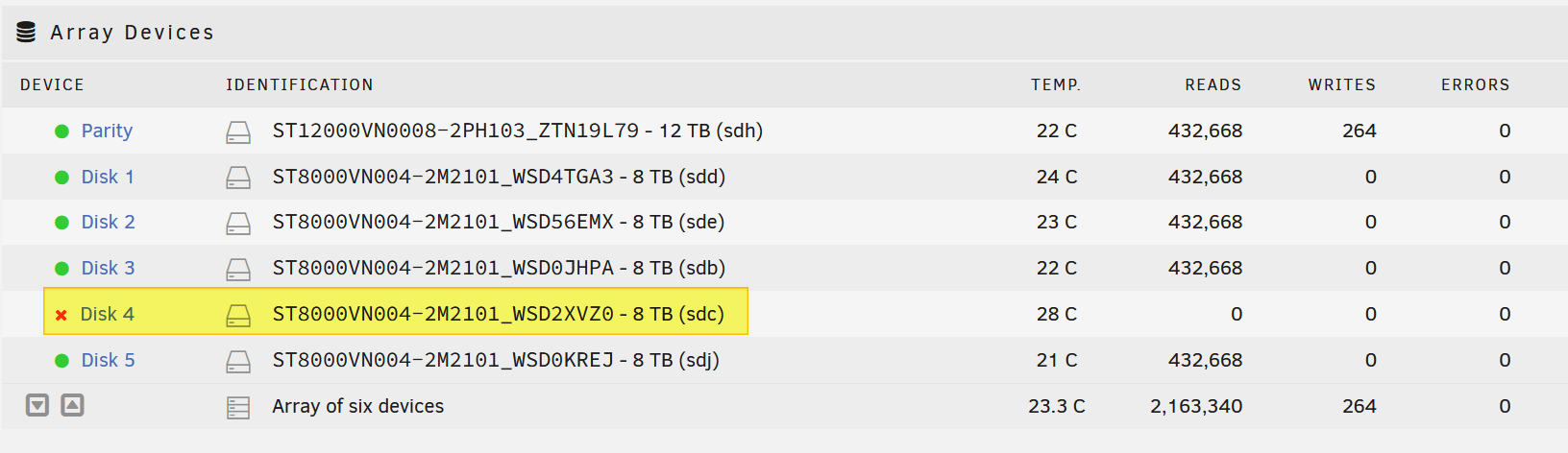

  6. I woke up this morning to a similar issue. 12TB Ironwolf Parity 5x8TB Ironwolf data /dev/sdc is disabled contents emulated. Server is in a 42u cabinet and hasn't moved or otherwise jostled so while I presently have not checked SATA and Power to the disk, I don't suspect that being an issue, but will be happy to. I just don't want to power down the server unless I know it's safe to do so. The disks aren't 2 years old, and were all pre-cleared prior to adding to the server. I started in Maintenance and did an fs check and repair, and SMART shows no errors. Extended SMART has been running for about 6 hours and is currently at 80%, but was hoping I could seek some expert assistance in the meantime. Diagnostic from yesterday is attached, running another for today also. This is the Disk Log for /dev/sdc Mar 17 00:25:44 unraid emhttpd: spinning down /dev/sdc Mar 17 01:36:25 unraid emhttpd: read SMART /dev/sdc Mar 17 02:37:08 unraid emhttpd: spinning down /dev/sdc Mar 17 04:00:01 unraid emhttpd: read SMART /dev/sdc Mar 17 05:41:54 unraid emhttpd: spinning down /dev/sdc Mar 17 09:16:33 unraid emhttpd: read SMART /dev/sdc Mar 17 10:20:19 unraid emhttpd: spinning down /dev/sdc Mar 17 13:36:33 unraid emhttpd: read SMART /dev/sdc Mar 17 14:36:54 unraid emhttpd: spinning down /dev/sdc Mar 17 21:21:35 unraid emhttpd: read SMART /dev/sdc Mar 17 22:23:48 unraid emhttpd: spinning down /dev/sdc Mar 17 23:26:36 unraid emhttpd: read SMART /dev/sdc Mar 18 00:28:39 unraid emhttpd: spinning down /dev/sdc Mar 18 01:36:51 unraid kernel: sd 11:0:1:0: [sdc] tag#737 CDB: opcode=0x85 85 06 20 00 00 00 00 00 00 00 00 00 00 40 e5 00 Mar 18 01:36:55 unraid kernel: sd 11:0:1:0: [sdc] tag#752 UNKNOWN(0x2003) Result: hostbyte=0x00 driverbyte=DRIVER_OK cmd_age=7s Mar 18 01:36:55 unraid kernel: sd 11:0:1:0: [sdc] tag#752 Sense Key : 0x2 [current] Mar 18 01:36:55 unraid kernel: sd 11:0:1:0: [sdc] tag#752 ASC=0x4 ASCQ=0x0 Mar 18 01:36:55 unraid kernel: sd 11:0:1:0: [sdc] tag#752 CDB: opcode=0x88 88 00 00 00 00 00 c6 4e 37 48 00 00 00 08 00 00 Mar 18 01:36:55 unraid kernel: I/O error, dev sdc, sector 3327014728 op 0x0:(READ) flags 0x0 phys_seg 1 prio class 2 Mar 18 01:36:55 unraid kernel: sd 11:0:1:0: [sdc] tag#753 UNKNOWN(0x2003) Result: hostbyte=0x00 driverbyte=DRIVER_OK cmd_age=18s Mar 18 01:36:55 unraid kernel: sd 11:0:1:0: [sdc] tag#753 Sense Key : 0x2 [current] Mar 18 01:36:55 unraid kernel: sd 11:0:1:0: [sdc] tag#753 ASC=0x4 ASCQ=0x0 Mar 18 01:36:55 unraid kernel: sd 11:0:1:0: [sdc] tag#753 CDB: opcode=0x88 88 00 00 00 00 00 c6 4d 6d 30 00 00 00 08 00 00 Mar 18 01:36:55 unraid kernel: I/O error, dev sdc, sector 3326962992 op 0x0:(READ) flags 0x0 phys_seg 1 prio class 2 Mar 18 01:36:55 unraid kernel: sd 11:0:1:0: [sdc] tag#754 UNKNOWN(0x2003) Result: hostbyte=0x00 driverbyte=DRIVER_OK cmd_age=0s Mar 18 01:36:55 unraid kernel: sd 11:0:1:0: [sdc] tag#754 Sense Key : 0x2 [current] Mar 18 01:36:55 unraid kernel: sd 11:0:1:0: [sdc] tag#754 ASC=0x4 ASCQ=0x0 Mar 18 01:36:55 unraid kernel: sd 11:0:1:0: [sdc] tag#754 CDB: opcode=0x88 88 00 00 00 00 00 c5 97 90 d8 00 00 00 20 00 00 Mar 18 01:36:55 unraid kernel: I/O error, dev sdc, sector 3315044568 op 0x0:(READ) flags 0x0 phys_seg 4 prio class 2 Mar 18 01:36:55 unraid kernel: sd 11:0:1:0: [sdc] tag#757 UNKNOWN(0x2003) Result: hostbyte=0x00 driverbyte=DRIVER_OK cmd_age=0s Mar 18 01:36:55 unraid kernel: sd 11:0:1:0: [sdc] tag#757 Sense Key : 0x2 [current] Mar 18 01:36:55 unraid kernel: sd 11:0:1:0: [sdc] tag#757 ASC=0x4 ASCQ=0x0 Mar 18 01:36:55 unraid kernel: sd 11:0:1:0: [sdc] tag#757 CDB: opcode=0x88 88 00 00 00 00 00 c6 13 63 b8 00 00 00 20 00 00 Mar 18 01:36:55 unraid kernel: I/O error, dev sdc, sector 3323159480 op 0x0:(READ) flags 0x0 phys_seg 4 prio class 2 Mar 18 01:36:55 unraid kernel: sd 11:0:1:0: [sdc] tag#758 UNKNOWN(0x2003) Result: hostbyte=0x00 driverbyte=DRIVER_OK cmd_age=0s Mar 18 01:36:55 unraid kernel: sd 11:0:1:0: [sdc] tag#758 Sense Key : 0x2 [current] Mar 18 01:36:55 unraid kernel: sd 11:0:1:0: [sdc] tag#758 ASC=0x4 ASCQ=0x0 Mar 18 01:36:55 unraid kernel: sd 11:0:1:0: [sdc] tag#758 CDB: opcode=0x88 88 00 00 00 00 02 00 05 a0 60 00 00 00 10 00 00 Mar 18 01:36:55 unraid kernel: I/O error, dev sdc, sector 8590303328 op 0x0:(READ) flags 0x0 phys_seg 2 prio class 2 Mar 18 01:36:55 unraid emhttpd: read SMART /dev/sdc Mar 18 01:36:55 unraid kernel: sd 11:0:1:0: [sdc] tag#761 UNKNOWN(0x2003) Result: hostbyte=0x00 driverbyte=DRIVER_OK cmd_age=0s Mar 18 01:36:55 unraid kernel: sd 11:0:1:0: [sdc] tag#761 Sense Key : 0x2 [current] Mar 18 01:36:55 unraid kernel: sd 11:0:1:0: [sdc] tag#761 ASC=0x4 ASCQ=0x0 Mar 18 01:36:55 unraid kernel: sd 11:0:1:0: [sdc] tag#761 CDB: opcode=0x8a 8a 00 00 00 00 00 c6 4e 37 48 00 00 00 08 00 00 Mar 18 01:36:55 unraid kernel: I/O error, dev sdc, sector 3327014728 op 0x1:(WRITE) flags 0x0 phys_seg 1 prio class 2 Mar 18 01:36:55 unraid kernel: sd 11:0:1:0: [sdc] tag#763 UNKNOWN(0x2003) Result: hostbyte=0x00 driverbyte=DRIVER_OK cmd_age=0s Mar 18 01:36:55 unraid kernel: sd 11:0:1:0: [sdc] tag#763 Sense Key : 0x2 [current] Mar 18 01:36:55 unraid kernel: sd 11:0:1:0: [sdc] tag#763 ASC=0x4 ASCQ=0x0 Mar 18 01:36:55 unraid kernel: sd 11:0:1:0: [sdc] tag#763 CDB: opcode=0x8a 8a 00 00 00 00 00 c5 97 90 d8 00 00 00 20 00 00 Mar 18 01:36:55 unraid kernel: I/O error, dev sdc, sector 3315044568 op 0x1:(WRITE) flags 0x0 phys_seg 4 prio class 2 Mar 18 02:36:58 unraid emhttpd: spinning down /dev/sdc Mar 21 21:07:43 unraid emhttpd: spinning up /dev/sdc Mar 21 21:07:58 unraid kernel: sd 11:0:1:0: [sdc] tag#1285 CDB: opcode=0x85 85 06 20 00 00 00 00 00 00 00 00 00 00 40 e3 00 Mar 21 21:08:02 unraid emhttpd: sdspin /dev/sdc up: 22 Mar 21 21:08:02 unraid emhttpd: read SMART /dev/sdc Mar 22 14:20:14 unraid emhttpd: read SMART /dev/sdc Mar 22 14:23:10 unraid emhttpd: ST8000VN004-2M2101_WSD2XVZ0 (sdc) 512 15628053168 Mar 22 14:23:10 unraid kernel: mdcmd (5): import 4 sdc 64 7814026532 0 ST8000VN004-2M2101_WSD2XVZ0 Mar 22 14:23:10 unraid kernel: md: import disk4: (sdc) ST8000VN004-2M2101_WSD2XVZ0 size: 7814026532 Mar 22 14:23:10 unraid emhttpd: read SMART /dev/sdc Mar 22 14:47:04 unraid emhttpd: read SMART /dev/sdc Mar 22 14:47:07 unraid emhttpd: ST8000VN004-2M2101_WSD2XVZ0 (sdc) 512 15628053168 Mar 22 14:47:07 unraid kernel: mdcmd (5): import 4 sdc 64 7814026532 0 ST8000VN004-2M2101_WSD2XVZ0 Mar 22 14:47:07 unraid kernel: md: import disk4: (sdc) ST8000VN004-2M2101_WSD2XVZ0 size: 7814026532 Mar 22 14:47:07 unraid emhttpd: read SMART /dev/sdc unraid-diagnostics-20240321-2118.zip
