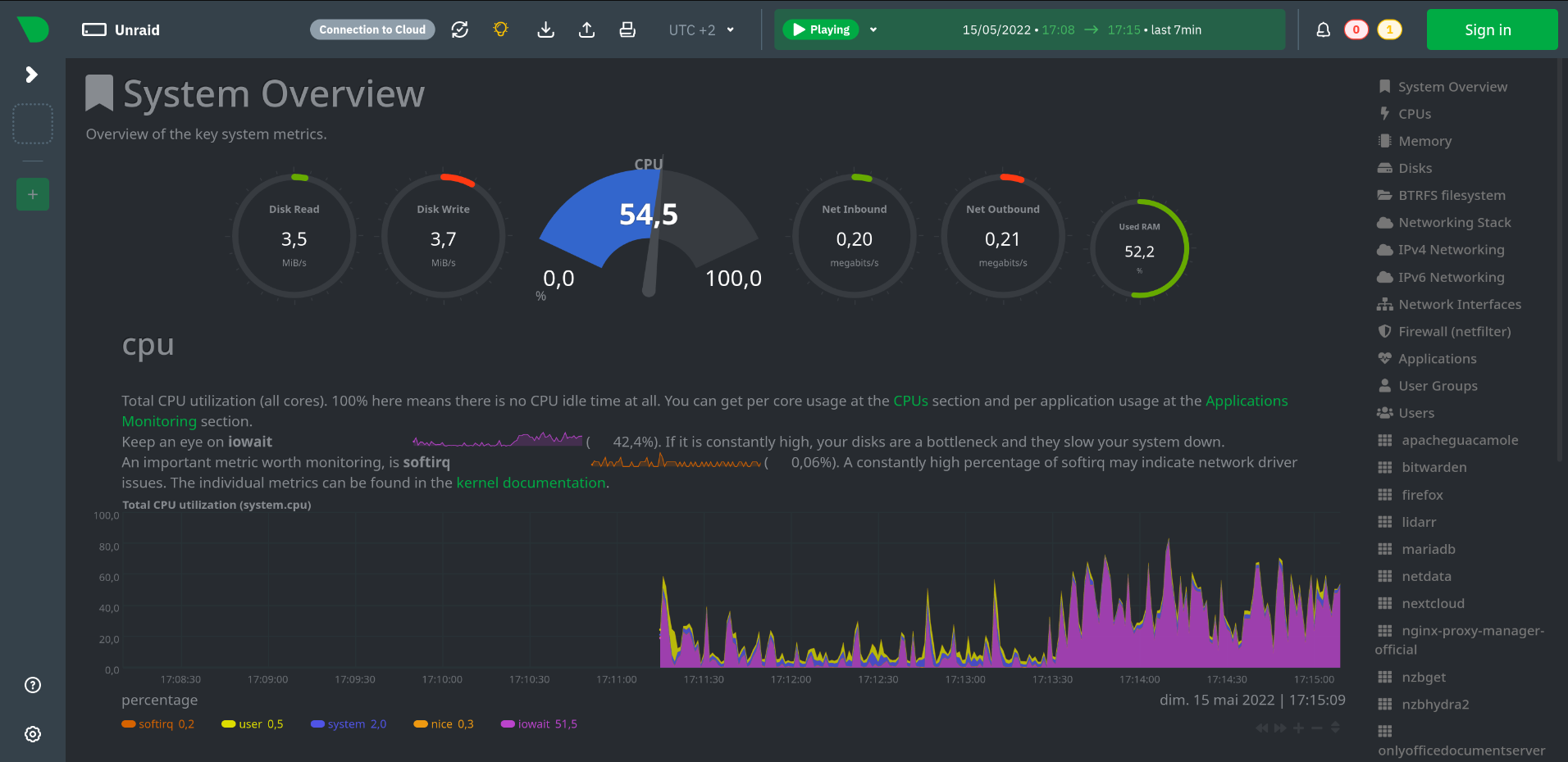

The IOWait was also confirmed by Netdata (here is an example but IOWait can go above 90%) :
So first I tried to see if this high IOWait was because of a particular docker container. But even shutting down all container, the IOWait keeps being high for a few minutes before coming back to normal value (<3%), so it looks as it was not because of a container but with docker itself. When IOWait come back to low value, the docker tab/docker commands become responsive again.
I also saw in Netdata that during high IOWait, the disk usage was at 100% on the parity drive but not on other drive.

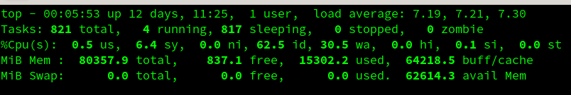

@Squid reading through this thread, I can see that my IOwait is over 20, sometimes close to 30 (or more)
I made the bone-headed move of evacuating my 4 array disks one at a time, and changing them to ZFS because I figured that was smart.
@MAM59 corrected me due to very painfully slow transfer speeds of 16-20 MB/s on my array, that ZFS was the culprit and I should re-convert all my disks back to XFS.
