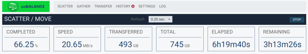

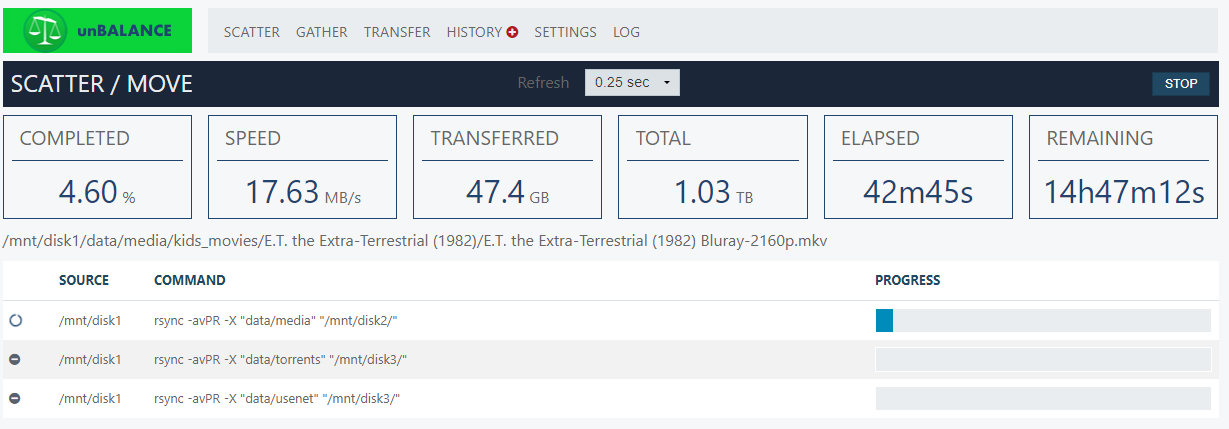

My array disks were all xfs as default, and using unbalance to move data on the disks was moving at about 30mb/s.
I was doing this with the intention of converting the array disks to zfs with unraid 6.12.3
Enabling turbo write didn't seem to solve the problem.
Now I am trying to redistribute the data a little more evenly across the array disks, all of which are zfs.
Moving about 700G of data has taken so far about 9.5 - 10hrs.

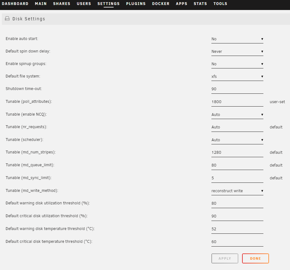

So now moving all the array disks back to XFS, and dropping down to 1 Parity disk, what else do I need to do in your collective opinions to realize something close to proper transfer speeds?
Does anything here look off to you folks? Or is there something I need to tune, or perhaps I may have changed at some point in the past that's messing with my speeds?

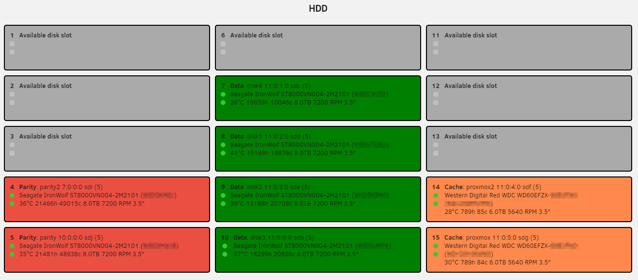

what are those 2 "cache" drives good for?
For "cache" you should use fast (as fast as possible) drives and not slower ones than the one of the main array. (your main disks turn around with 7200 RPM whereas your cache is slow with 5640 RPM, thats just pain and no gain)
So its "slow down" instead of "speed up"
stop the copy, turn off cache, restart the copy (using the same parameters as before, it will skip already moved files and just continue from where it was stopped) and see if there is a speed improvement.
Update: the above maybe a bit misleading. The slow cache won't help you with your copy. UNRAID uses the cache only for writing NEW files from the Network. Once Mover did his evil ( 🙂 ) job, they reside on the array. The idea is that the cache is fast and can keep up with LAN speed even for huge files. Your cache is the opposite.
Edited by MAM59
The two WD RED 6TB drives are used for my ProxMox backups that are shipped to unraid over a 10G DAC.
They aren't used in unraid in any cache capacity other than a place to sit until backups kick off at 3am.
my appdata and downloads sit on a Samsung 980 Pro (not pictured)
ah ok, so I was mislead by the graphics and the naming scheme.
980 Pro is fast enough for 10G, good choice!
