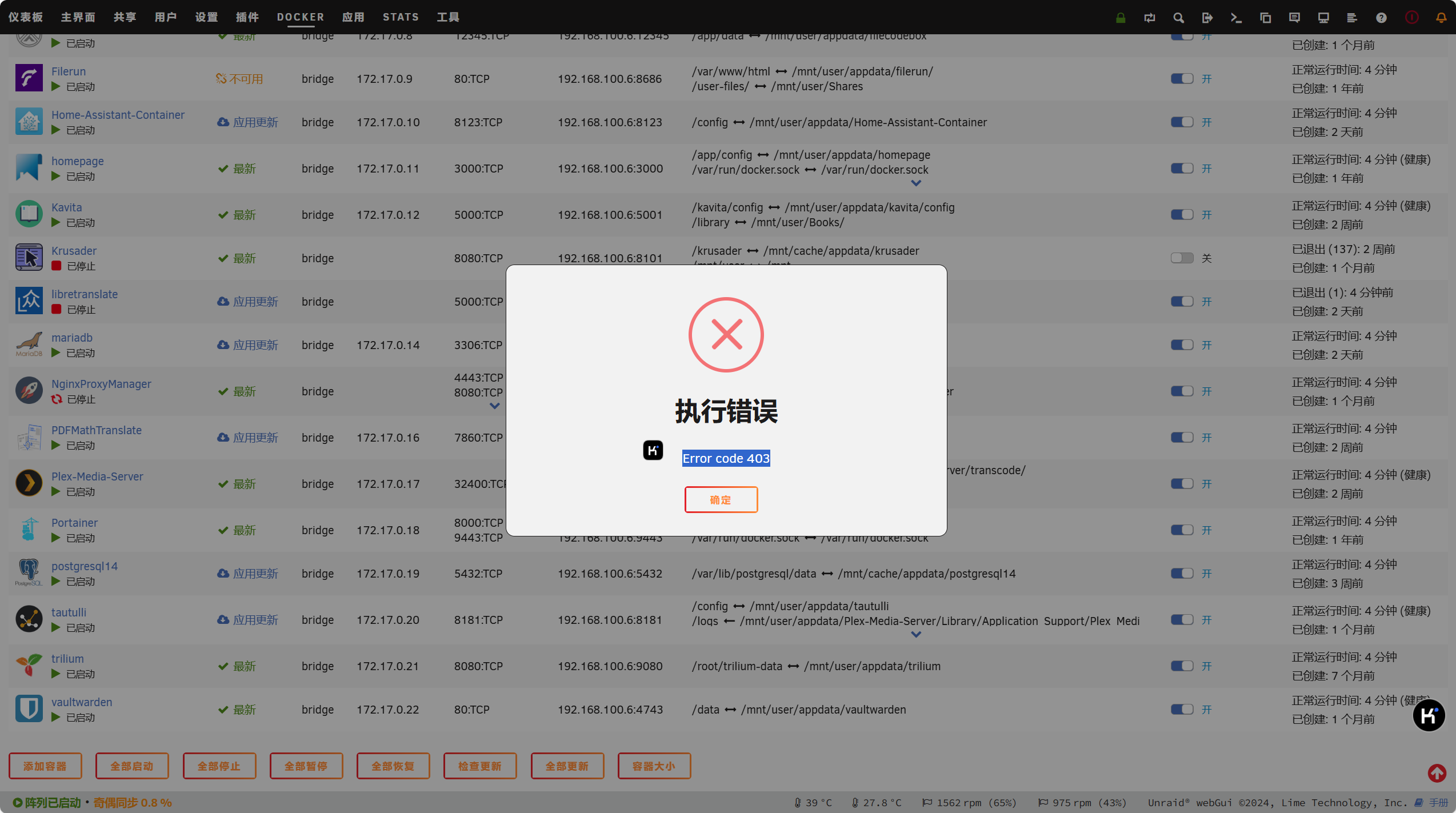

启动后,一些 Docker 容器可以启动,而其他容器将立即自动关闭。当我尝试手动启动它们时,收到一条错误消息,指出“错误代码 403”。

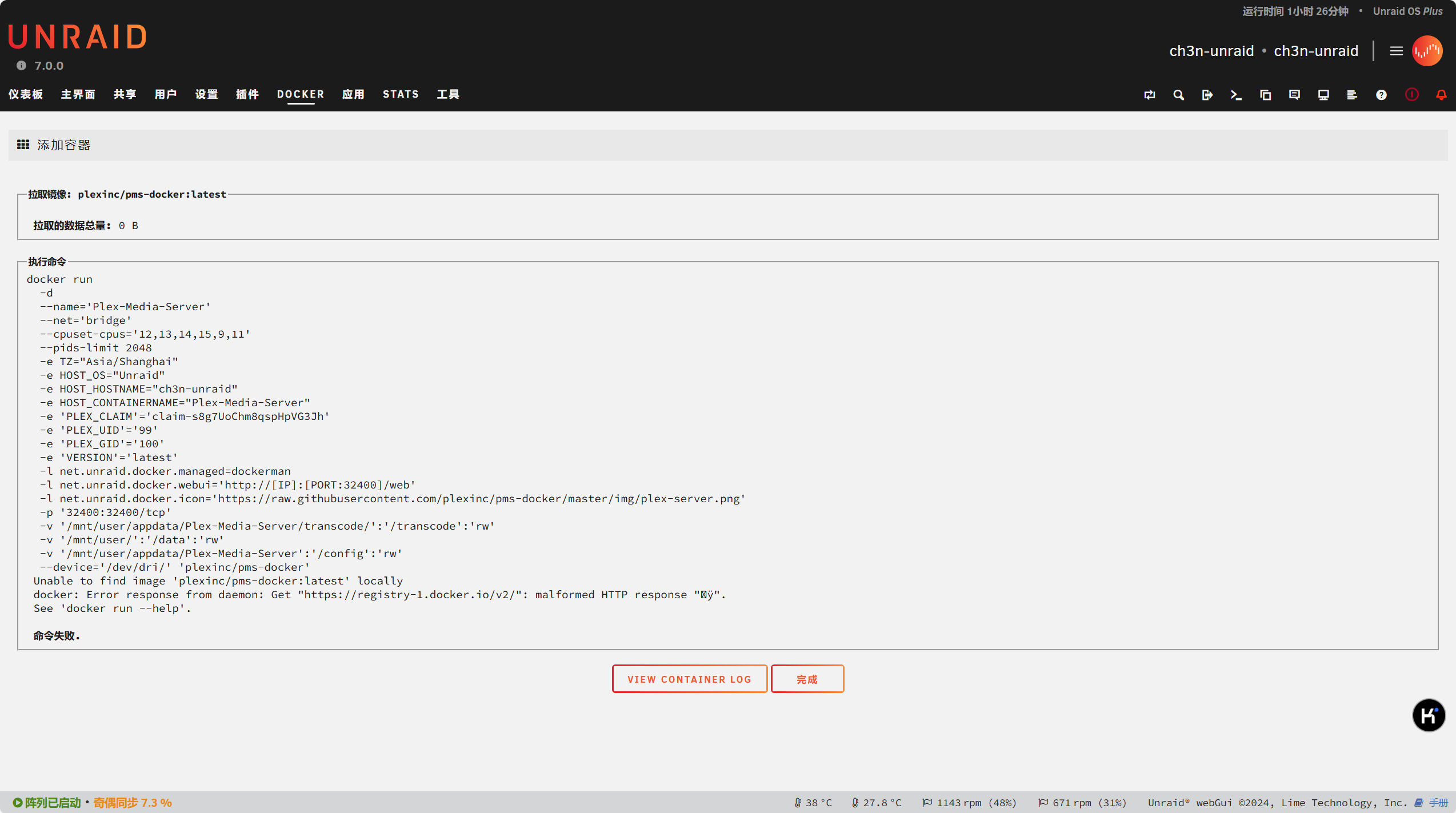

After deleting the original docker.img, an error will occur:
Unable to find image 'plexinc/pms-docker:latest' locally
docker: Error response from daemon: Get "https://registry-1.docker.io/v2/": malformed HTTP response "ÿ".
See 'docker run --help'.

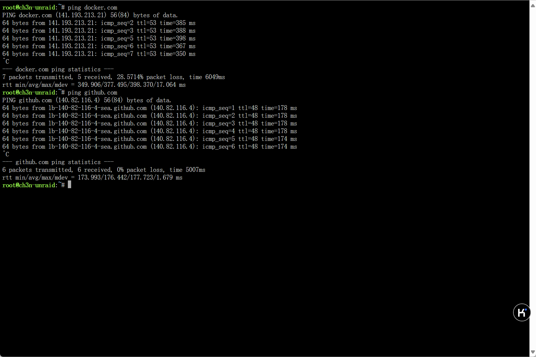

However, it is still possible to ping docker.com / github.com.

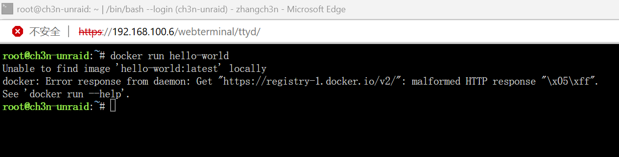

Type in the CLI
docker run hello-world
and post that output
It's not a container issue, it's the docker service or a network problem, I would start by resetting the docker service:
