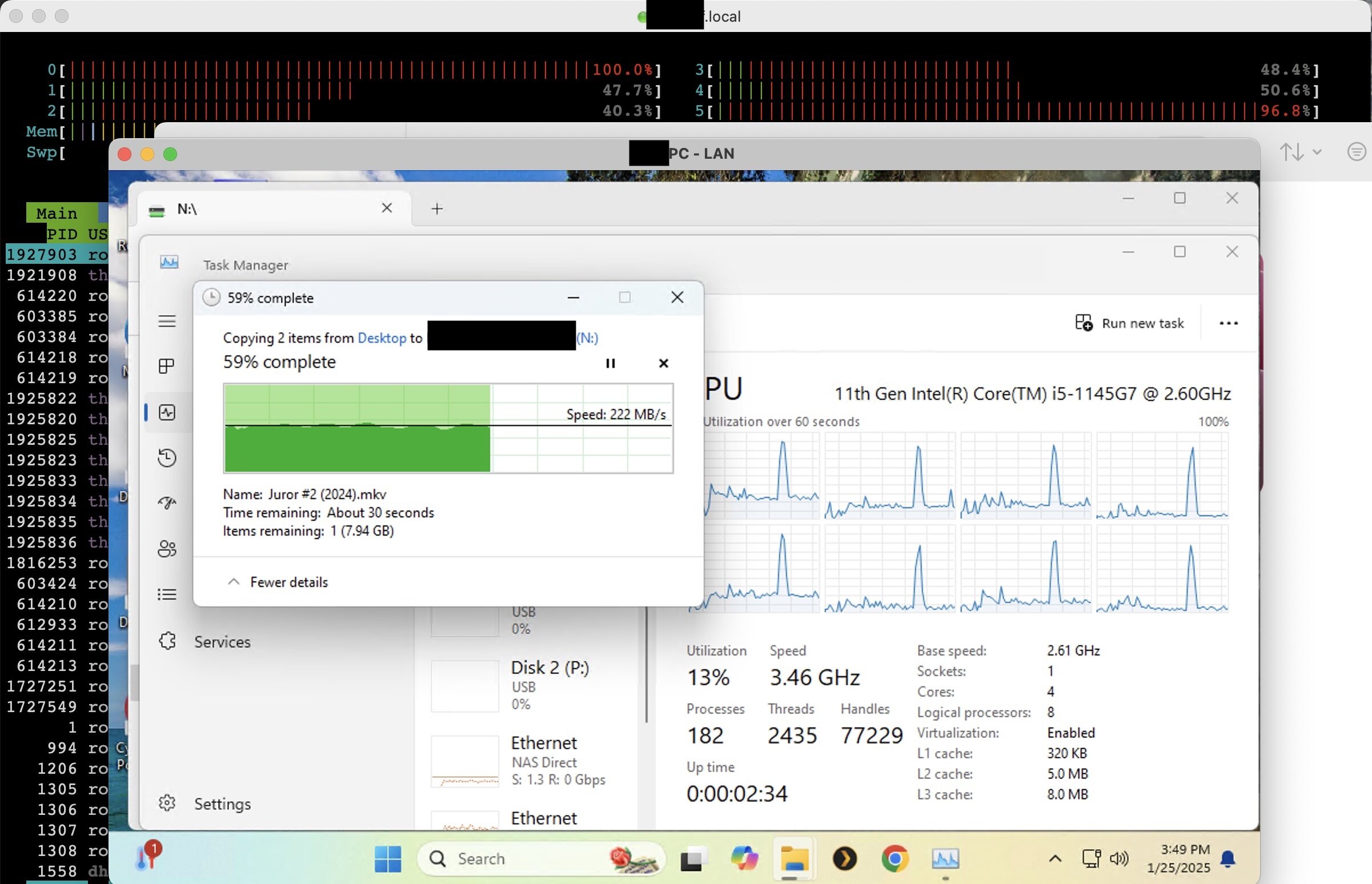

Testing with a 20GB movie, I get 220MB/s from PC to NAS and 300MB/s the other way. I might try downgrading Unraid and see what happens.
Here is a picture of what is going on CPU-wise when transferring from the PC to the NAS. In the background is utop showing the NAS's CPU usage, and windows task manager is showing the PC's core usage. My understanding is that SMB has more overhead on the NAS side of things.Screenshot2025-01-25at3_49_35PM.thumb.jpeg.646949fa9ad6ea300fca3b64a95454ba.jpeg

Update: downgrading Unraid OS did not help. Replacing the CPU with an i9-9900K helped a lot. With no changes to my settings, I am getting 1GB/s write speeds to disk shares. I still get much lower writes to user shares (650-700MB/s), but from looking online this seems to be normal behavior. For now, I will keep writing to my cache via the disk share and let the mover take care of transferring it to the array.
