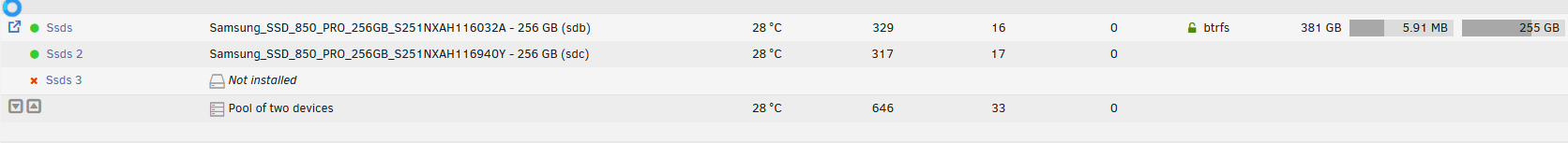

I've added the SSDs into a pool and it's showing a third drive, even though I selected the pool as 2 devices.

I've attempted to remove the Pool which basically just stalls the GUI.
2025-01-27 02_15_30-ANC-S-01_Main - Brave.png+
The pool can't be removed via GUI, has to be removed via deleting the pool cfg file. There appears to be something wrong with the config somewhere else?
That is likely what caused the issue, pool is missing a device, v7.0 supports importing a degraded pool, but not removing the missing device, please post output from:
btrfs fi usage -T /mnt/ssds
I can then post the command to remove the device manually, and then you just need to reimport the pool once more.

With the array started, type on the CLI
btrfs dev del missing /mnt/ssds
Once the device is removed, it should take a few seconds, stop the array and reimport the pool again:
on main click on the first device for that pool and then "remove pool"
back on main, create a new pool with the same name and number of slots
assign the pool device(s), leave the filesystem set to auto
start the array to import the pool
Whelp.. you made that pretty easy tbh. If you're not getting paid for supporting all of us, you should be.
