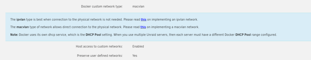

Docker Networks add a custom where preserver will let advanced users make there own network! a none/disabled and or add data for ipv6
I'm starting to hit a issue with createing overlaping docker netwroks as I want ipv6 and Ipv4.
as the host network won't faciltate this.. and due to at boot and webui docker setting for ipvlan or macvlan..

Due to unraids webui Docker settings.. I would like to see a custom/no docekr network so a advance user can create there own docker network for ipv6 support...

to be clear I want a docker option to stop the creation of unriads control and use over creating the custom br0 network... i would rather have preserve user defined and let teh user defiune them!!!
