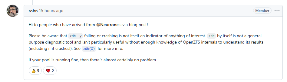

If you mean using the zdb -y command, see this:
No, the author is quite clear about that in his post:

  • Edit: in a previous version of this post, I suggested running zdb -y on pools to detect metaslab corruption. However, I’ve since learned that zdb should not be used to detect corruption, even if it crashes. I’m sorry for any undue alarm that this may have caused.

Like mentioned, that zdb -y test appears to be irrelevant.
