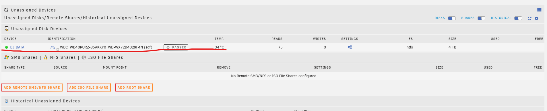

Can not make a pass-through HDD work in VM after upgrade to v.7

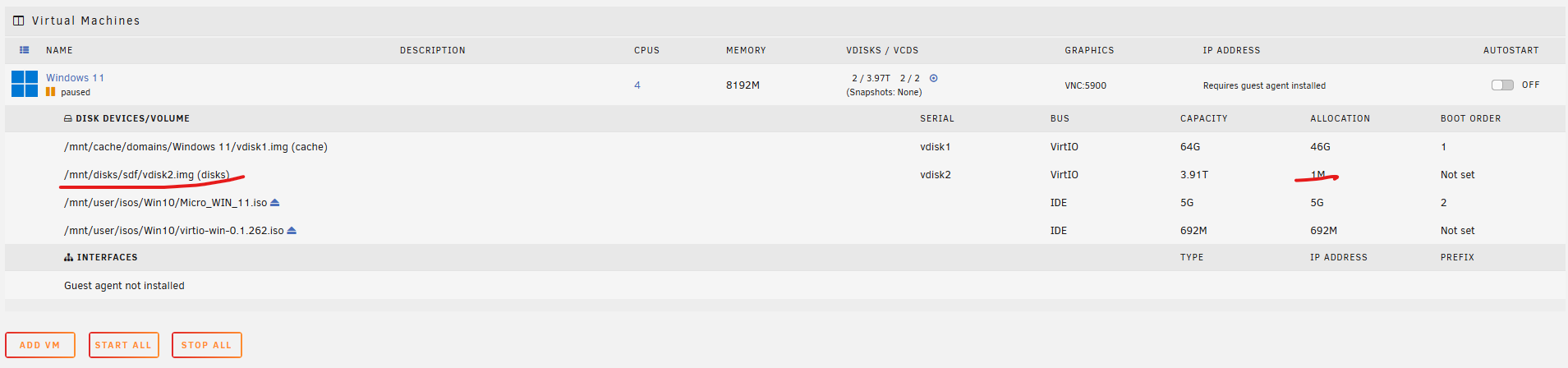

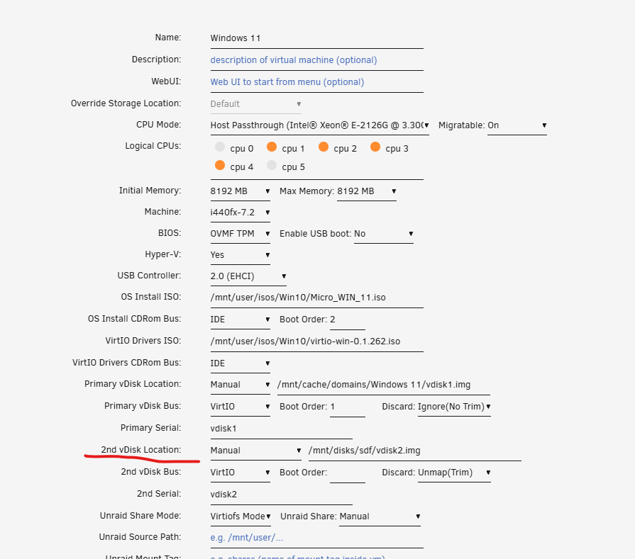

I have a problem after upgrading to v.7 of unraid. I had Win11 VM and a separate 4TB HDD passed through in the system. VM was able to see the 4TB HDD and use it. After the upgrade VM lost the config for the passed-through HDD. I manually added the HDD back to VM again and had to initialize the HDD in the VM itself under disk management. This never happened before when I was upgrading between versions. All I had to do was to point the VM to the HDD and then addthe HDD under disk management in the VM and that was it. This time I have to initialize the drive and format it. When I start formatting VM freezes (goes in to PAUSE state). Is there anything different in the v.7 for adding the pass-through HDD to a VM? I used to do it by selecting 2nd vDisk Location: under VM settings and then manually adding the disk /mnt/disks/sdf.

  • force-stopped VM and added the 2nd Vdisk location - manual>/sdf(in my case the pass through HDD is sdf)
  • type - SATA
  • started the VM
  • inside VM went to windows>tools>storage  management and initialized the drive and then formatted it. This time it allowed me to do everything without freezing the VM.
Not sure which one of the steps fixed my issue, but tend to think its the setting for 2nd vdisk location which needs to be simply /sdf
