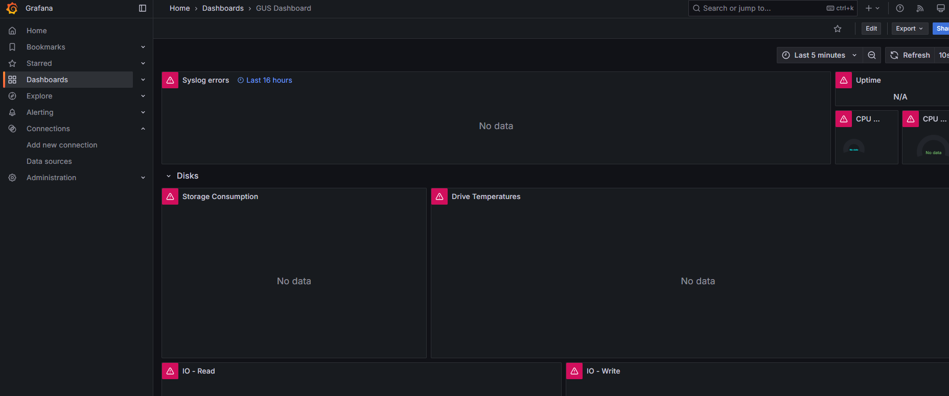

  5. hi, I'm experiencing a similar issue as reported by @harshl. Also, I am new to grafana and want o make sure I don't need to make modifications to the docker from the default install. i installed docker and selected 'GUS Dashboard'. Thanks.
