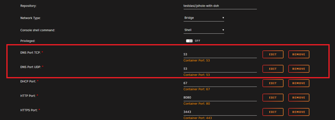

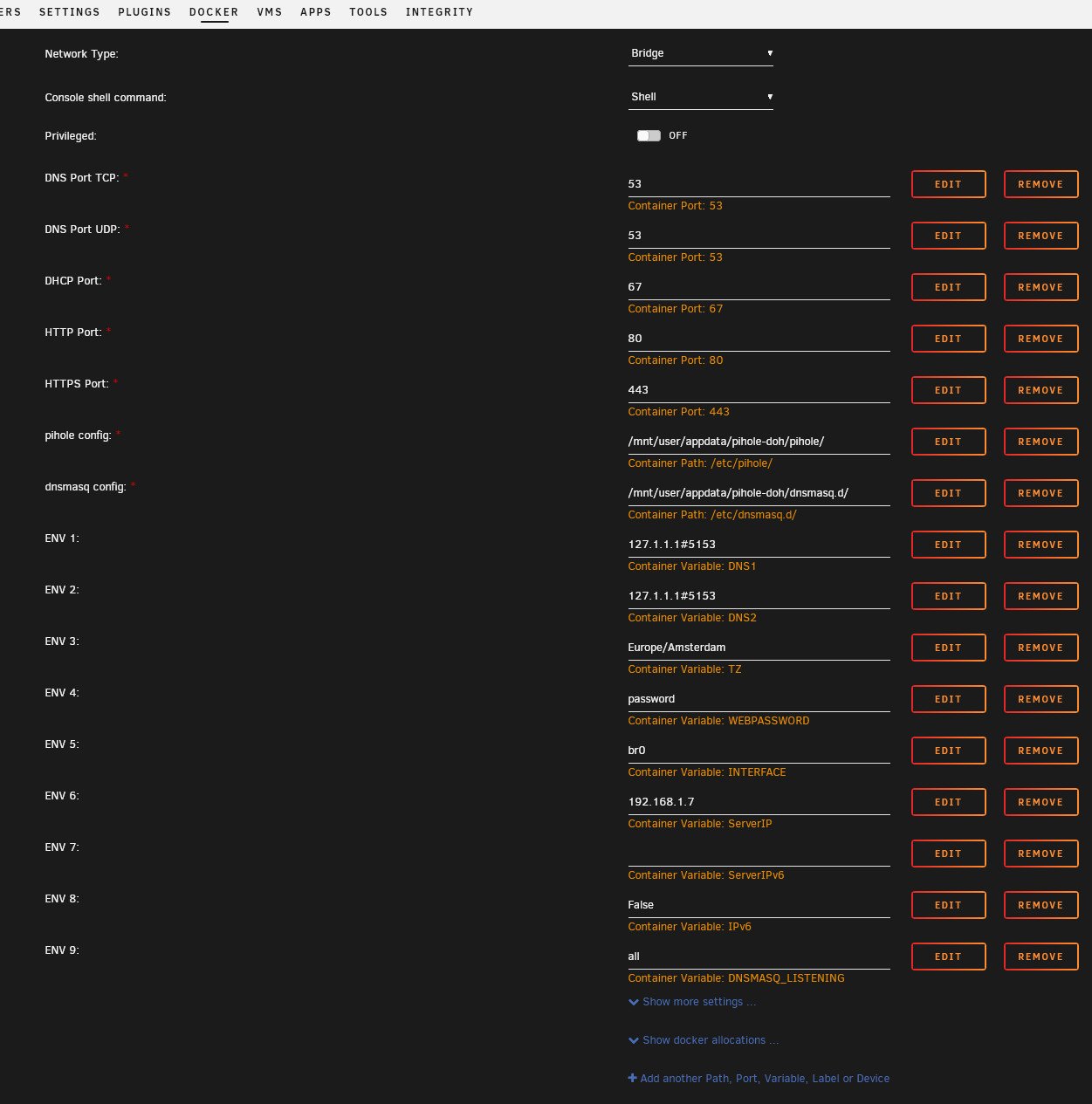

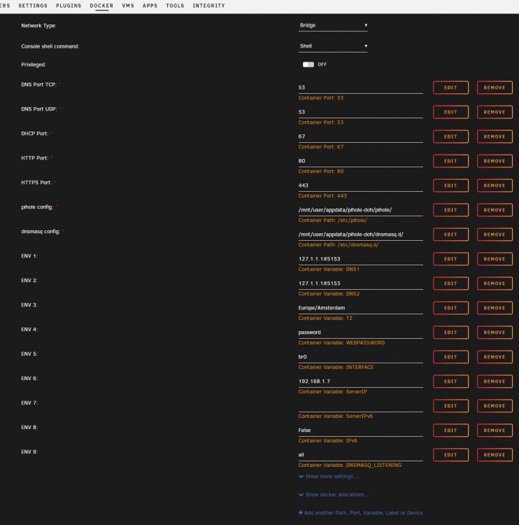

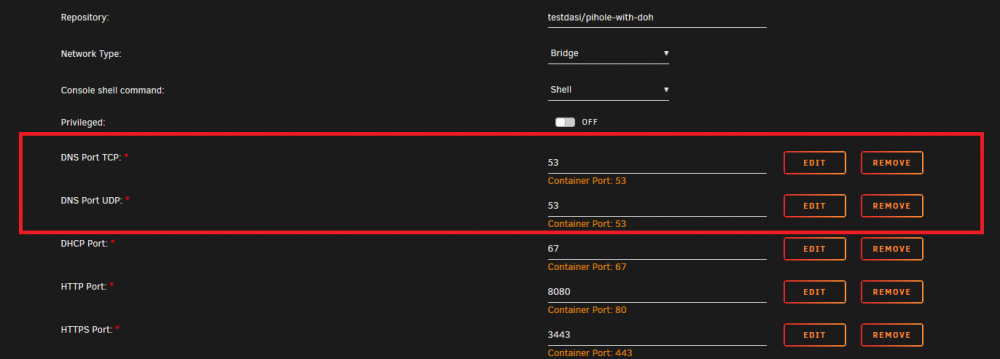

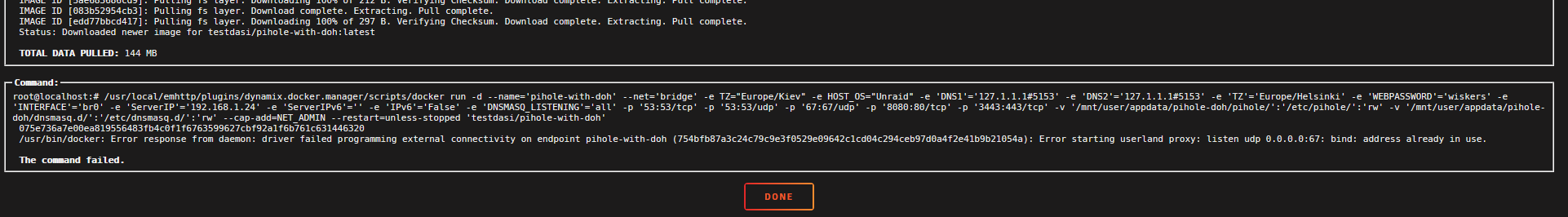

root@localhost:# /usr/local/emhttp/plugins/dynamix.docker.manager/scripts/docker run -d --name='pihole-with-doh' --net='bridge' -e TZ="Europe/Berlin" -e HOST_OS="Unraid" -e 'DNS1'='127.1.1.1#5153' -e 'DNS2'='127.1.1.1#5153' -e 'TZ'='Europe/Amsterdam' -e 'WEBPASSWORD'='password' -e 'INTERFACE'='br0' -e 'ServerIP'='192.168.1.7' -e 'ServerIPv6'='' -e 'IPv6'='False' -e 'DNSMASQ_LISTENING'='all' -p '53:53/tcp' -p '53:53/udp' -p '67:67/udp' -p '80:80/tcp' -p '443:443/tcp' -v '/mnt/user/appdata/pihole-doh/pihole/':'/etc/pihole/':'rw' -v '/mnt/user/appdata/pihole-doh/dnsmasq.d/':'/etc/dnsmasq.d/':'rw' --cap-add=NET_ADMIN --restart=unless-stopped 'testdasi/pihole-with-doh'
39f5fd7455f1fa5dfed989b1cefa10fdebea845722d37b2dc8861afc9b8c0203
/usr/bin/docker: Error response from daemon: driver failed programming external connectivity on endpoint pihole-with-doh (ec98edf36e66ae40c9ead8078e625cbcc65563379fd10c2073956e49ac008095): Error starting userland proxy: listen tcp 0.0.0.0:443: bind: address already in use.
The command failed.
Whatever I do, I can't seem to get it running.
Sweet job on these, thanks for the work. Any change of one with pi-hole and unbound?
On 8/27/2020 at 11:21 PM, itsmebal0o said:
Just edit the docker container, make sure advanced view is on and at the --hostname parameter...
Thanks!
The command failed.
You need to give the docker its own IP. There's something using port 443 according to the error.
Alternatively map port 443 to a different port.

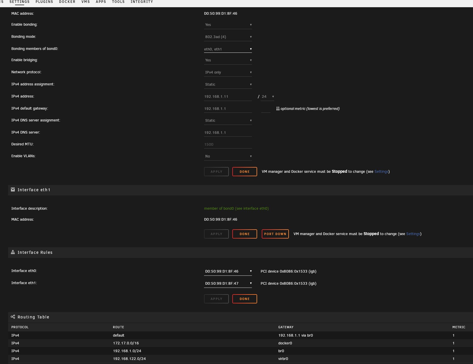

Already tried both options, and more. It doesn't work. Unraid runs on 2 interfaces (eth0 and eth1, as bond0) with 192.168.1.11, I've set the docker to use a free IP 192.168.1.7, but even when I set it to use the same IP and different ports (81 and 445 for example), there's no pihole web-ui running. The docker keeps failing to start, and when it does start it says it's using 192.168.1.11, which I did not set. Attached are the network config and docker config. (Good grief, what do people see in those docker containers? It's a complete flaky network-mess, full of translations, redirections and proxies, adding latency and complexity. And extra webservers running just for one app. I keep saying it; VM's are more efficient, easier to maintain and easier to make accessible. But much to my surprise, pi-hole doesn't even properly support being installed on Debian 10, with the shipped php-fpm and nginx, otherwise I already would have done that in the VM's I run on this unraid server.
The command failed.
Same issue. Looks great but unfortunately I can't free up port 80 or port 443 because I am using them with LetsEncrypt. The other PiHole container works fine though without any conflicts right from the beginning.
EDIT: I changed to use port 8080 and 3443 for this container but I am still getting an error that a port is in use. Also, shouldn't both these ports be different in the default config? Either way, I'm getting a server error and the container won't even start.
EDIT FINAL: Well I worked out that it has to be set at its own I.P. address like OP said. I read that but didn't really get it because it looked like it was just an option in the container config at the bottom. So setting it to "Custom: br0" and giving it its own I.P. address solved the problem completely using default settings.
After adding lists it works great. Though it did crash when I attempted to update 65 lists at the same time. It seemed to add the lists successfully but when updating them it crashed. So rebooting caused them to all be updated before the PiHole container finished starting.
Big thanks to the OP. I've been looking for something with HTTPS over DNS for ages.

On 8/31/2020 at 1:08 PM, Julius said:
There is no "Custom: br0" under my docker Network type options. Already gave it its own IP (as I clearly wrote), still it fails saying its IP is 0.0.0.0, which it is not.
I switched off docker support for my unraid entirely. Back to using VMs for all, much easier to maintain, to secure (csf/lfd firewall), no strange translations, soft-linking or proxying, and I found a very good config for pihole using a nginx server.conf with php-fpm here.
Settings -> Docker -> activate "IPv4 custom network on interface br0".
What it does is Unraid would create a macvlan custom docker network so you can assign custom IP for any docker.
Caveat: if your VM uses the same bridge as the dockers then under kernel 5.x (Unraid 6.9.0+), you will have spurious errors spamming your syslog. The workarounds for this Linux kernel annoyance is outlined in the Unraid 6.9.0 release notes.

Solved by workaround.
Changed Unraid DNS to 1.1.1.1 and it worked.
It's not a workaround but a requirement. Pointing Unraid network config to an Unraid docker just won't work.
So Settings -> Network Settings has to use DNS server not hosted on the Unraid server itself.
Hence, I have a RPi4 for this.
