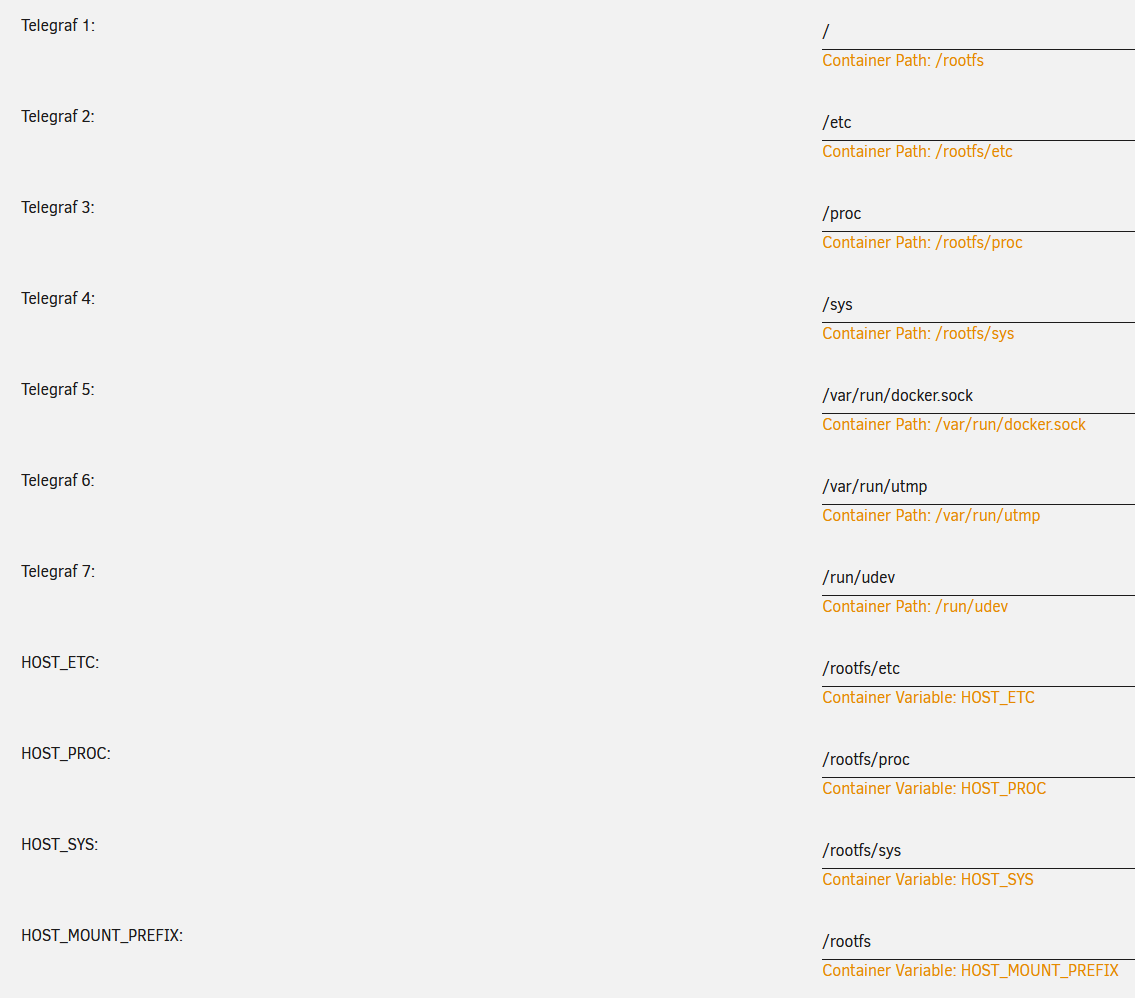

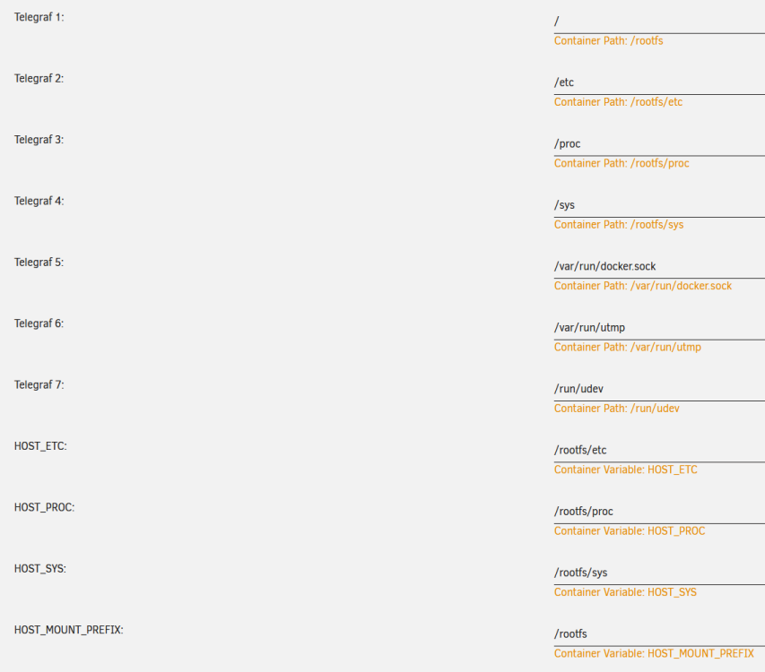

Anyone manage to monitor UPS trough this Grafana Stack ? Am using the plugin NUT V2 (the embedeed one in unraid doesnt work for my EATON)

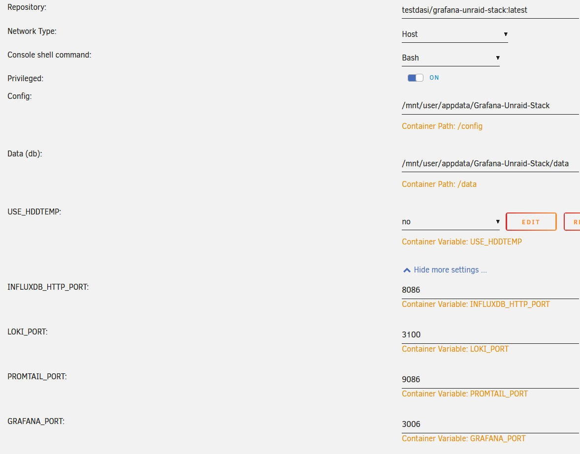

I am doing a fresh, new install of latest, and getting this too. I have tried at least 3 different repo's and 3 different revisions- no luck.
The good news is this repo is the one that comes closest to working - only grafana is failing.
The logs in the container are absolutely empty for grafana.
At console I execute "grafana-server" it says "Grafana-server Init Failed: Could not find config defaults, make sure homepath command line parameter is set or working directory is homepath"
Can someone kind soul out there take a look at this? There are too many building blocks required to get this stack working, and I am not familiar enough with any of them to even start troubleshooting through those.
Thank you.

in case you were wondering, i got this to work by going into the console, editing the /usr/share/grafana/grafana.ini to port 3006 than using grafana-server --homepath='/usr/share/grafana' --config='/usr/share/grafana/conf/defaults.ini' to launch the grafana server from the console. it worked but the dashboards that are preconfigured werent there and i lost all motivation to re-establish them
*Edit: if you install the OG container, then change it to the kyle one, you can follow the steps i posted and get the GUS dashboard! this was a lot of work lol

I have just try to installed this app but in the logs, everything crashed on startup.
I have included the container's logs and the configuration
image.thumb.png.d34fd7844f97695053d0e78c2d156cc1.pngimage.thumb.png.ef907e4e3aafd59684f130b47cbd1a80.png
Logs:
On 5/15/2023 at 6:24 PM, KyleK29 said:
Alright, got it working again with a forked image. If anyone else wants to try (I do recommend spinning up a different copy, just for testing purposes). All you have to do is swap the repository of the GUS package / Docker container to this (right-click the Docker Containers Icon --> Edit --> find "repository"):
kylek29/grafana-unraid-stack-2023:latest
FYI. This is still working.
Original testdasi image wasn't working for me. This kylek29 image worked right away. No tweaks needed.
Thanks!
