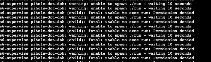

Since the last update, my query log indicates that domains are being properly white or blacklisted, but I get no replies and thus no internet on my devices using this DNS. Configured with DoH 127.1.1.1#5153. Happening on multiple Unraid docker hosts, and to a friend that recently updated as well. If I change to 1.1.1.1, it works fine, but obviously not secure.
Edit 1:
After some additional digging, it appears cloudflared is not running since the update. My queries start working after running this command in the terminal:
/usr/local/bin/cloudflared --config /config/cloudflared.yml
Edit 2:
Looks like the run file doesn't have permission to execute.
Edited by marcuspohl
Added additional info and screenshot

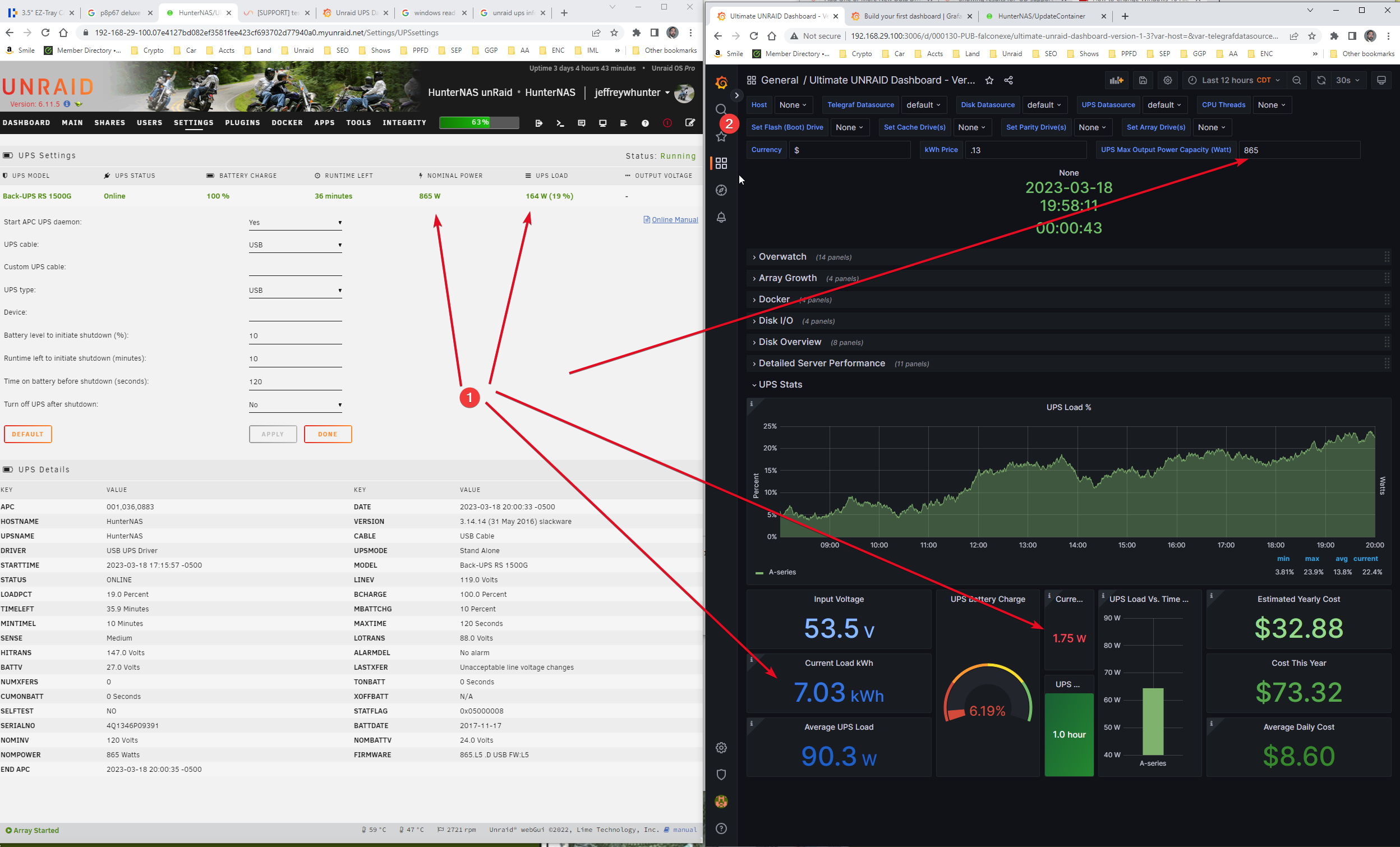

Hi, new to grafana.  Installed the Grafana Unraid Stack (Thanks for building this!).  Interested in the UPS monitor.  Access grafana at IP:3006 and it displays "Dashboards".  Tried to login with the default admin/admin, but it appeared to not work, but then I was logged in.  Never used these tools before, so complete newbie.  Apparently I'm in Grafana and see Influxdb-Telegraf and Loki data sources, admin user, lots of plugins, etc.  A number of questions, I'm sure are just config/setup.
1. Was able to activate the General/Ultimate Unraid Dashboard, but there was no data.  Refreshed the page and data appears.   However, the data is wrong (see screenshot).  See #1: I've set UPS Max Output capacity (865) but the Current Load kwh (7.03) does not match what the UPS is reporting in the Unraid UPS settings (164w).  The number does change in the dashboard, but its never even close to what the UPS Settings shows.
2. There are a number of settings in the dashboard (See #2) that don't have any options.  All are set to None and that is the only selection.  Don't see anywhere to set any of the variables (CPU Threads, Flash Drive, Cache Drive, Parity, etc.).
3. Did a minor rearrange to the dashboard (moved UPS to top), tried to save but got the following message:
This dashboard cannot be saved from the Grafana UI because it has been provisioned from another source. Copy the JSON or save it to a file below, then you can update your dashboard in the provisioning source.
Assuming also a "newbie does not know where to make changes" error.
Love what I'm seeing, just need to learn how it works.
Thanks for the assistance!
Jeff...
