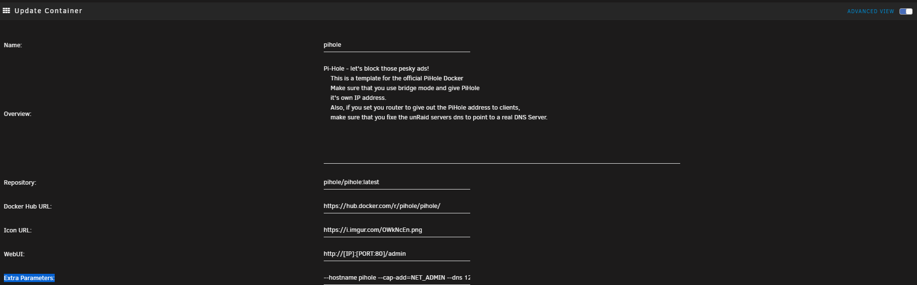

Regarding pihole, I have a situation where I have a segmented Vlan for all dockers, which means when pihole tries to talk out to the Unraid specified vlan, it tries to go to another network.
Is there anyway to hardcode something that is on the same vlan/subnet?

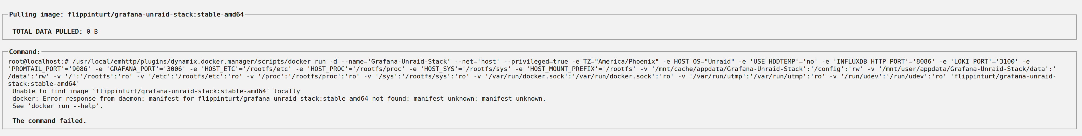

Looks like it is trying to install GUS from local? I made some major revisions and changes to my server so i decided since I saw this to try GUS since my own custom setup was done years ago, half of it is broken now, 15,000 dockers, it works but it s a mess honestly. Unfortunately I can't get this installed at all, any thoughts?

I had just installed this, and then saw no recent activity by the owner.  Is this no longer maintained?  If not, I'll just go through the work of installing Grafana/Telegraf/Influx solo and go that route.
Last update to the Grafana Unraid Stack container was 20 days ago.
Hi - I was having constant issues with Influxdb error: Bad Request with my UUD 1.5 setup using separate Grafana, Influxdb, Varken and Telegraf dockers. So I installed GUS and its been smooth sailing. Imported the .JSON for UUD 1.5 and that works too.
What's not working is the grafana pie chart and world map plugin. When I try and install through command line, it says cli tools are not installed. Googling around gave a manual way to download the plugins through command line. The default downloads to /tmp. When I try and go there through Krusader, the .zip is not there. When I try through command line it can never find the file either.
Is there another way to install these plugins? Thank you!

How the heck do you change the hostname of pi-hole? i have set it in dhcp server. but i cannot for the love of me find a setting in pi-hole to change it. nor config files?
Can someone let me know?
@Darren Cook You have to add --hostname hostname under Extra Parameters in the PiHole Docker config
