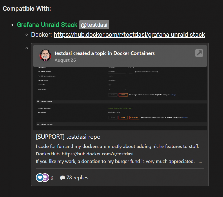

Hey @testdasi I just added a compatibility section on the UUD topic (first post on page 1) and tagged you.
Link:
Edited by falconexe

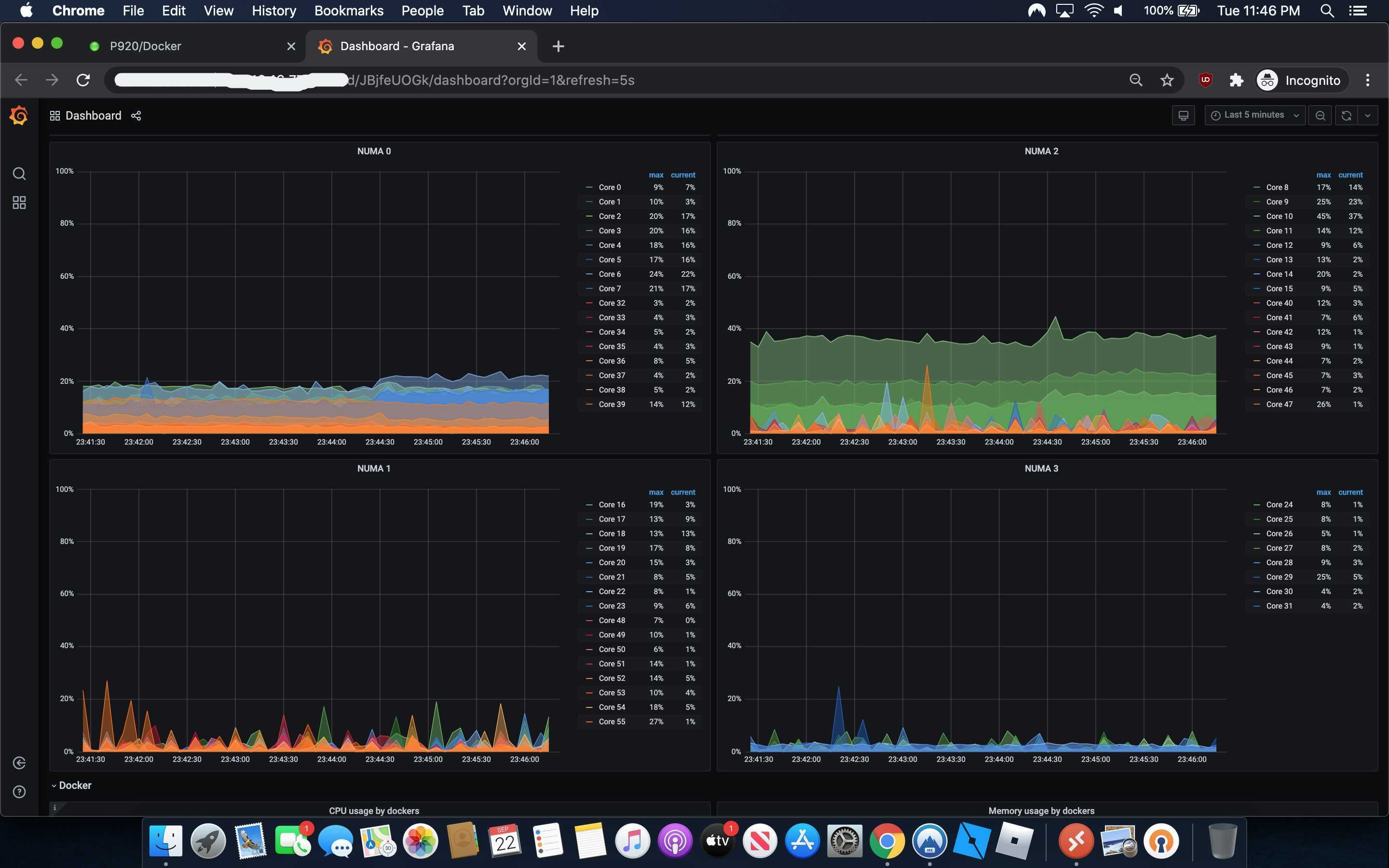

Why are my cpu cores listed/grouped this way?
The GUS dashboard is based on Threadripper 2990WX. You will have to customize the default dashboard to suit your own exact hardware.
Also give UUD a try to see if you like that layout more.

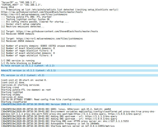

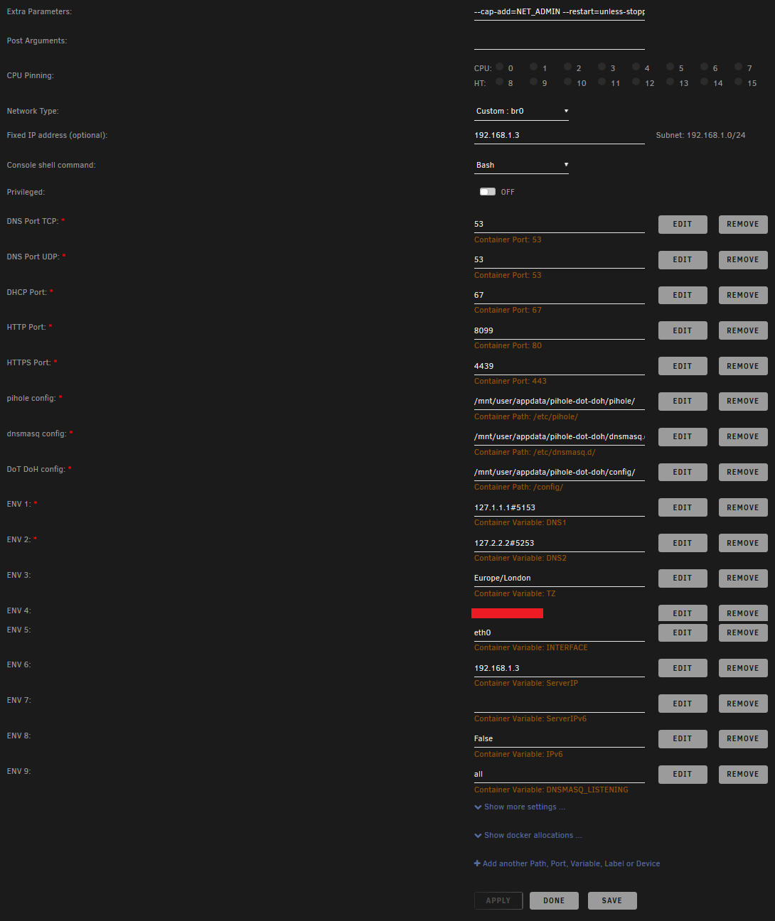

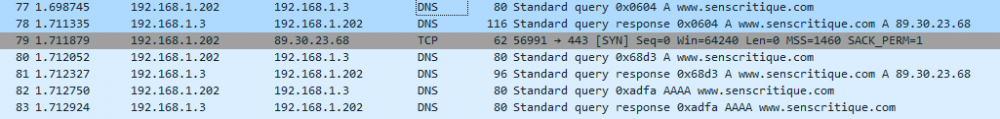

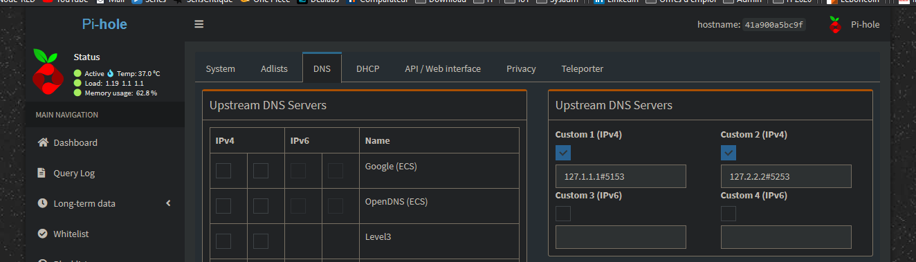

I've set Pihole-DoT-DoH like this on 192.168.1.3 (br0) :
Pihole is accessible on 192.168.1.3, and the logs show that the DoH proxy server is started :
So i've set the 192.168.1.3 adress as my only DNS server on Windows :
But when I start Wireshark and visit a website, the DNS request are still visible :
I'm not really good yet in networking, so I think i've miss something, but I don't know really what yet...
EDIT: UnRAID DNS is set to 1.1.1.1
Edited by koala784
Typo
The DNS queries within your network is not encrypted e.g. DNS between the client (192.168.1.202) and the Pihole docker (192.168.1.3).
It's the query out of the docker to the DNS resolver (e.g. from Pihole (192.168.1.3) to google (8.8.8.8)) that is encrypted.
