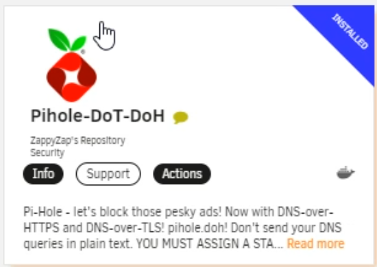

On 7/6/2024 at 6:49 PM, sdballer said:
Is there another DoTDoH version that is supported you'd recommend?
zappyzap:
You can change the repository via advance options and reuse the same template. As they are practically identical
ZappyZap has been keeping track of updates and has a better rep of keeping things updated for pihole...
*Do at your own risk it is best to teleport backup your data and install fresh!

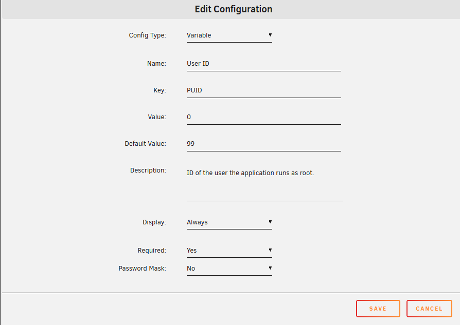

Double check file docker permissions.
?cd /mnt/user/appdata/Grafana
chmod 777 -R *
chown nobody:users -R *
you may need to stop all dockers and rerun the docker new perm under unraids tools.
I had to also add a GUID and a UIUD for Grafana to fix additional file access issues.
0 is root
99 nobody
100 users
I experienced similar when Grafana had a update a few tags ago and had to fix file permission and how Grafana runas x users to clear up the errors.
