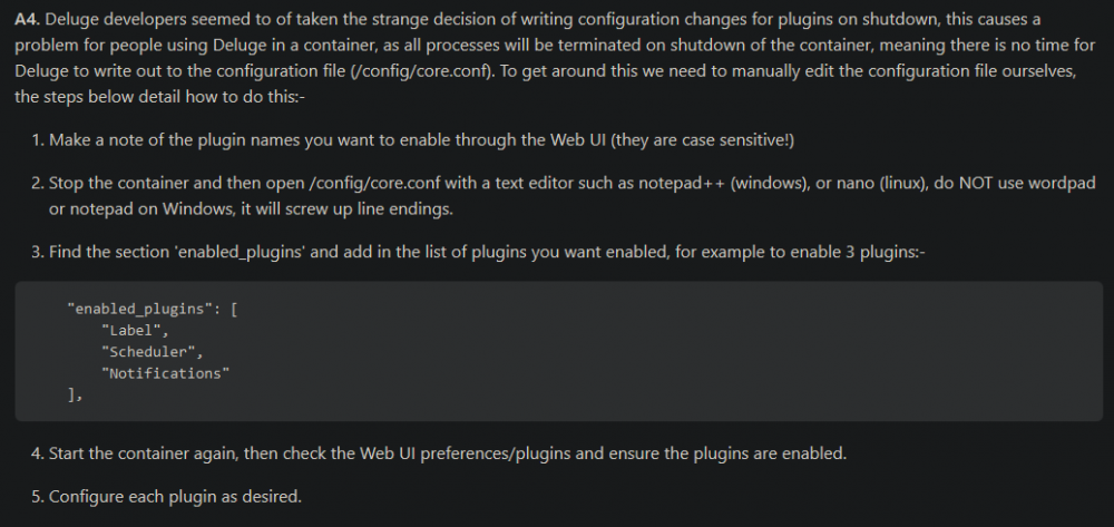

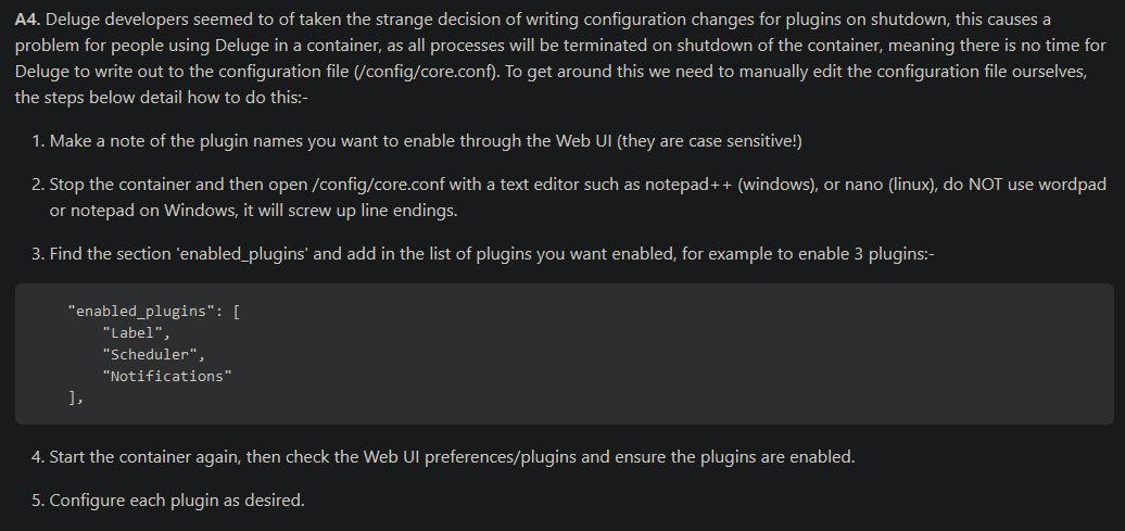

35 minutes ago, testdasi said:
This is a known bug with Deluge (see bug report below). As binhex himself said "if the plugin is not made for deluge v2 then you will be out of luck until the plugin developer updates the plugin to work with python 3.x". Binhex seems to have implemented his own fix so I think you might have no choice but to use his docker instead.
https://github.com/binhex/arch-delugevpn/issues/66
Ok I'm gonna go with the binhex one for now, and try to find a workaround

EDIT: For the Label plugin issue on Deluge, your link was helpful, there is a workaround, thanks again ;)

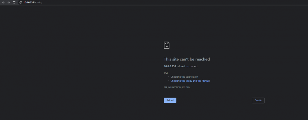

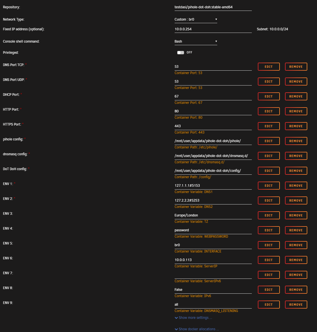

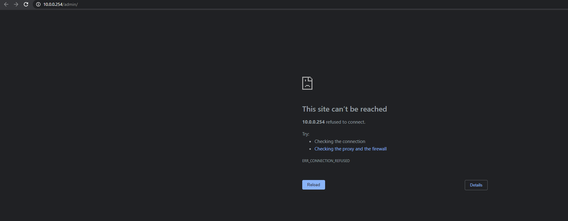

Pihole dot doh ---
i think there might be a config issue - after installing and matching regular pihole template, aside the required settings, there is no webgui.
Uninstalled, removed image and deleted the folder in appdata. Reinstalled with a new static local ip, same issue.
Uninstalled original (working) pihole, deleted folder etc. Reinstalled and the gui works right away. Am i possibly missing something?
I can ping google from console successfully.
Edited by jonfive
