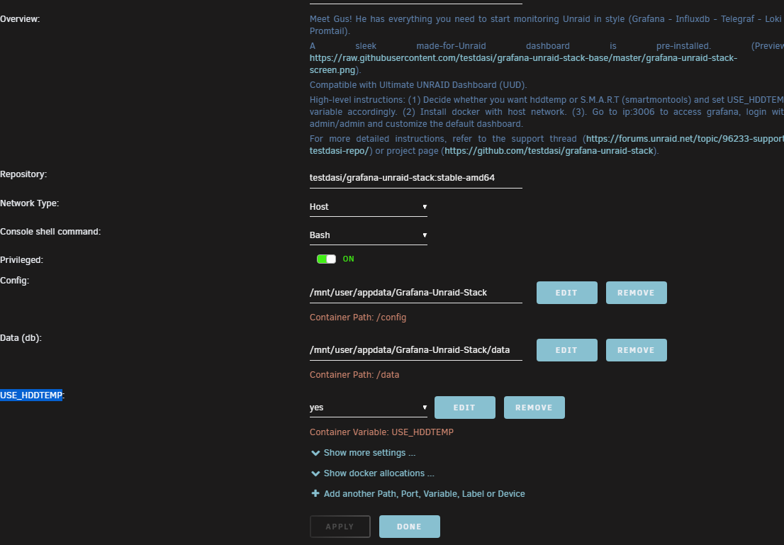

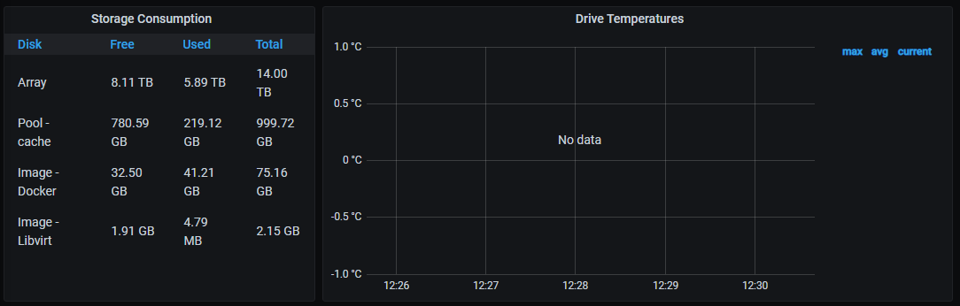

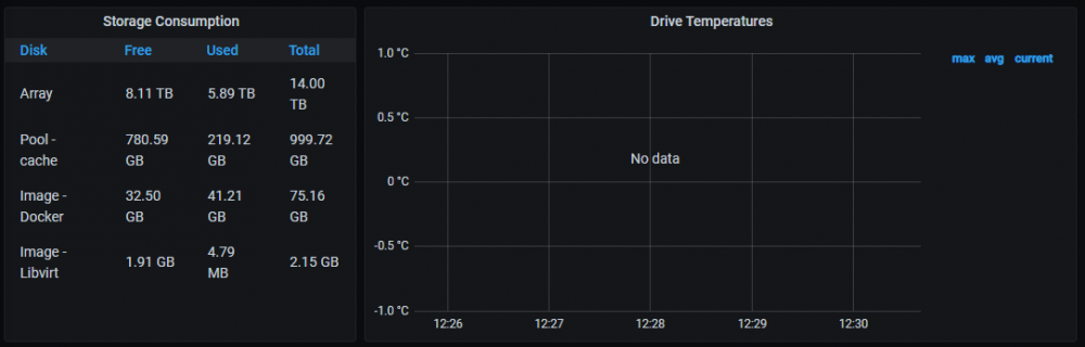

Hello,
I download your Grafana-Unraid-Stack for test it.
It works very good but in the hdd graph i have the message "No Data".
I choose yes option in the docker template for the USE_HDDTEMP:
I attach some capture.
Thank you very much

6 hours ago, rachid596 said:
Hello,
Thank you very much
You can either edit the graph to change the parameters to use hddtemp or alternatively just wipe your config folder and reinstall with USE_HDDTEMP=no. The panels use SMART, not HDD_Temp. I only included the option because some prefer it over SMART (which is why it defaults to no).
