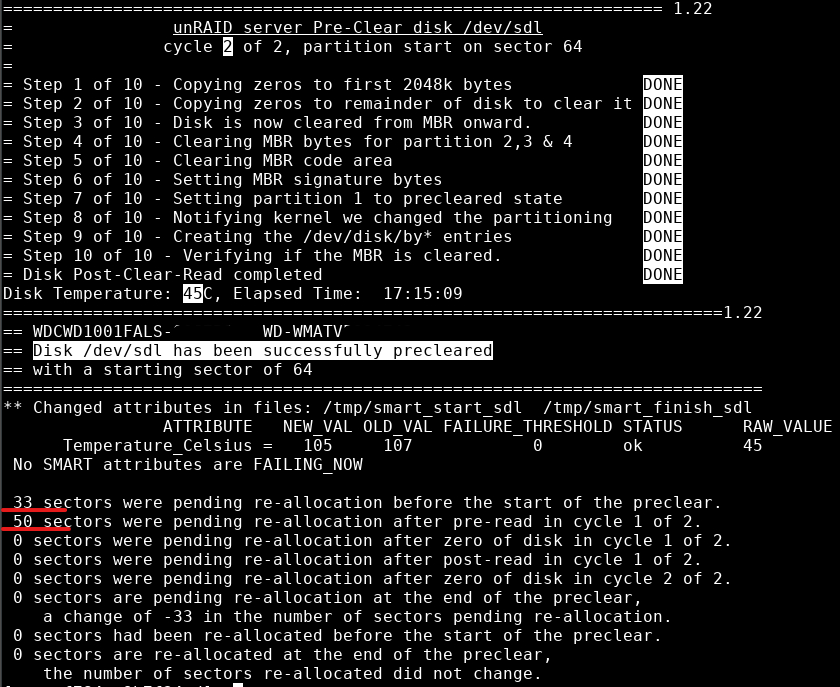

  5. How would you consider a drive like this? I mean, there were pending sectors at the start, but then they recovered.. I got those pending sector with the old PSU (a very cheap VS350 from Corsair) and the sata cables all bundled together.. now I'm using a much more respectable RM750i and I've also separated the sata cables to prevent crosstalk.. Maybe I'd do another 3 cycles just to be sure...

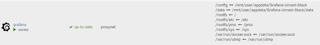

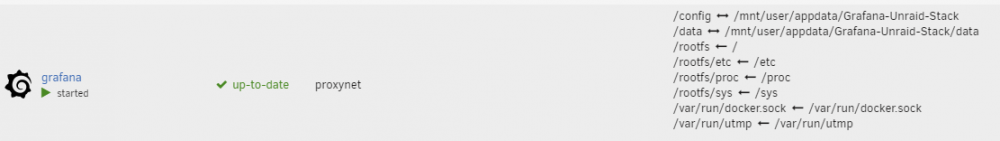

  6. Can someone help me a little with the configuration of GUS with linuxserver/swag ? I've selected network type: custom (picking the proxynet used by the other services that already use swag), but the docker won't get its ports mapped I know that's been written to leave network to host.. but that's why I'm asking for help 👼

  10. Just wanted to report that I was able to pre-clear two Seagate ST10000NM0086 drives at the same time. It took 48h15m each with the -f option. My CPU (Intel Core i3 9100 on an Asus WS C246M Pro/SE and 16GB of ECC DDR4 2400) was constantly at 100% during the writing process. Anyway, good work!
