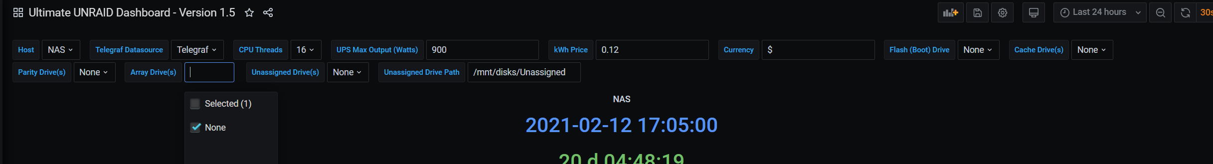

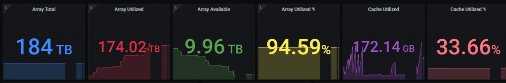

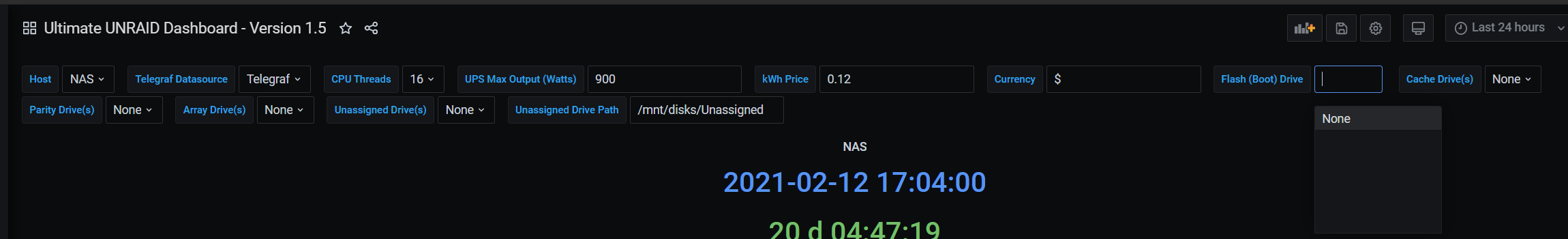

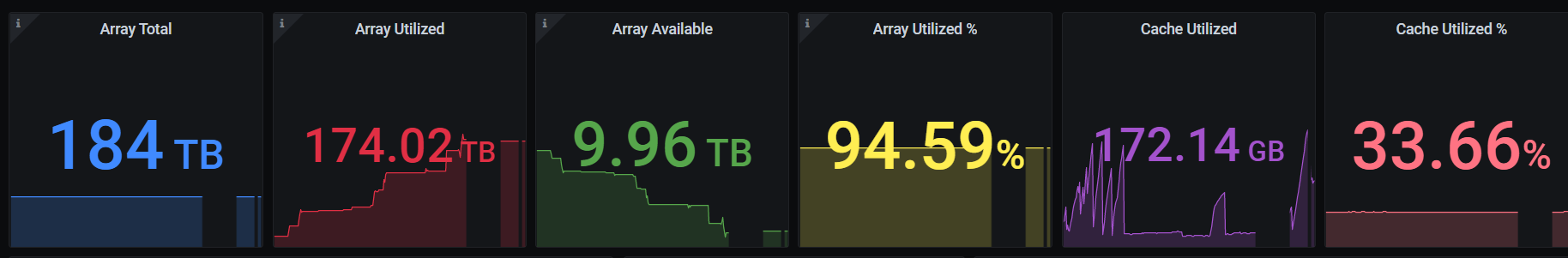

  5. Ok, I worked on it today, and finally have made some progress. I've got Varken up and running, feeding data into UUD, turns out that I hadn't designated the set the Varken DB into the various panels. So, that being said. I've got a few questions: 1) During my first attempt at this, I was able to designate my Cache/Array/Parity/Flash drives. On this attempt, when I select the drop down for a given drive, my only option is "None" I am seeing array stats, and the drives are showing up under the Drive S.M.A.R.T Health overview So I'm really not sure why the drives aren't populating in the Flash/Cache/Parity/Array areas. 3) Some panels indicate that they require IPMI and REGEX. I've installed the IPMI tools, but not sure how to do REGEX. Also, I'm seeing this in my telegraf log: 2021-02-12T23:17:50Z E! [inputs.sensors] Error in plugin: failed to run command /usr/bin/sensors -A -u: exit status 1 - So I need some assistance in addressing that. Thanks for any help!

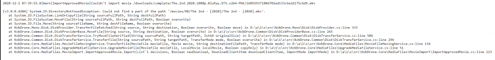

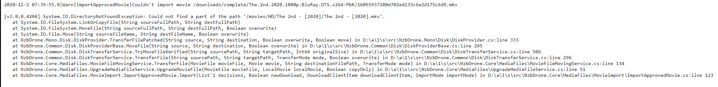

  9. OK, with the upgrade to v3 over the weekend, I'm finding very sporadic success in having my downloads imported into Radarr. I'm seeing frequent errors such as below Everything was working flawlessly prior to the v3 upgrade.
